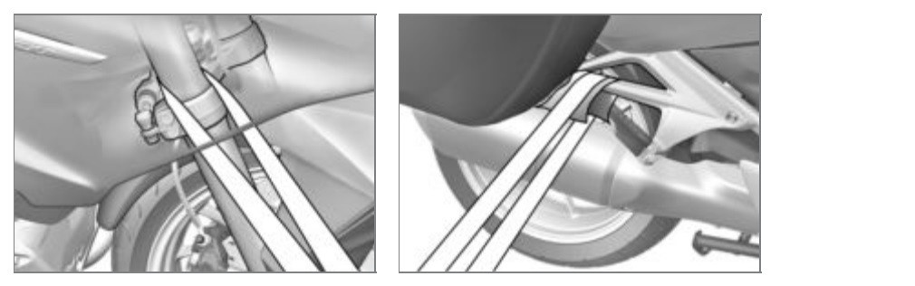

Hi. Just in case you are not aware but it is not recommended to tie an RT down by the handlebars at all. I remember reading something a few years ago that it damages the front suspension. The tie down point is to wrap around each fork just above the bottom fork clamp. That gives a solid tie point but does not damage the bars and suspension. The rear ties go behind the rear foot pegs onto each bracket. Hope this helps.
Re: r1250rt handlebar width
Here you go.
Tie Down Points.jpg (55.27 KiB) Viewed 1395 times

Thanks so much for the tie-down tip. The attached diagram is especially informative. Will be using standard ite downs attached to the fork legs.
