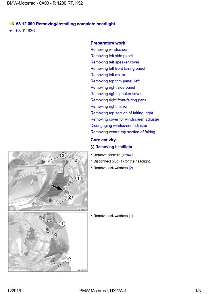

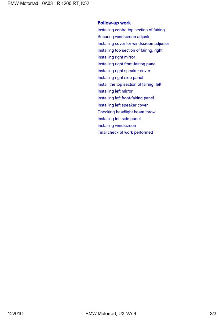

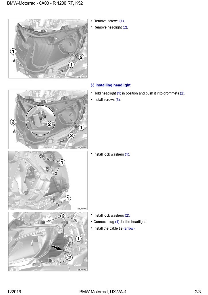

Take a look for the headlight here, it may help

thank you for the information, this will help with the removal of the light.
Could you please send the link to the information on removing the top fairing panel? I can not open it from the link you sent.
