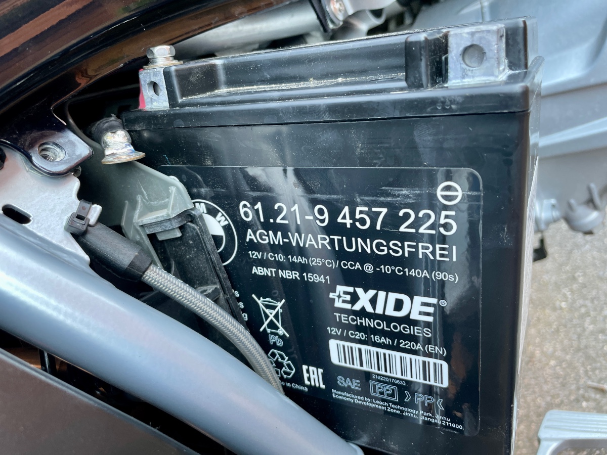

My 2020 showed signs of problems about four weeks after I got it second hand last January. When I questioned the dealer i was told unoficially that the new 1250's eat batteries. I was given a deal on a battery charger and told to keep it hooked up when not in use, which I wasn't happy about but did anyway. Last Sunday after a round trip of about 150 miles it was slow to turn over, so I've looked at a replacement. Do I go for the Exide from Nippy Normans which is the battery BMW fit without the sticker or a Yuasa from Tayna? A lesser man might thing that BMW didn't design a space big enough on the bike to fit a battery that could handle the drain.... ;)

My local Halfrauds online say they have a Yuasa in stock for £78 which is cheaper than the Exide with postage from NN and Tayna but I have to collect in store which is about 8 miles each way, CCA's on Yuasa is 230a while Exide is 170a. Question is do I stump up the dosh for a better battery knowing the RT may eat it?

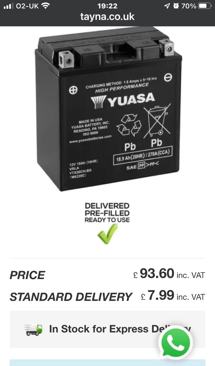

I bought the Yuasa YTX20CH-BS from Tanya, same size as standard but higher rate, and recommended by Yuasa for the RTLC.

Steve398 wrote: Thu Mar 14, 2024 7:22 pm I bought the Yuasa YTX20CH-BS from Tanya, same size as standard but higher rate, and recommended by Yuasa for the RTLC.
Thanks for that, interesting thing is when I looked at Tayna for this battery to order it, it came up with the EXIDE ETX20CH-BS as a star buy in this size with 230CCA's....at £ 55.57 the same CCA's as the more expensive Yuasa I was going to buy originally... :| :|
