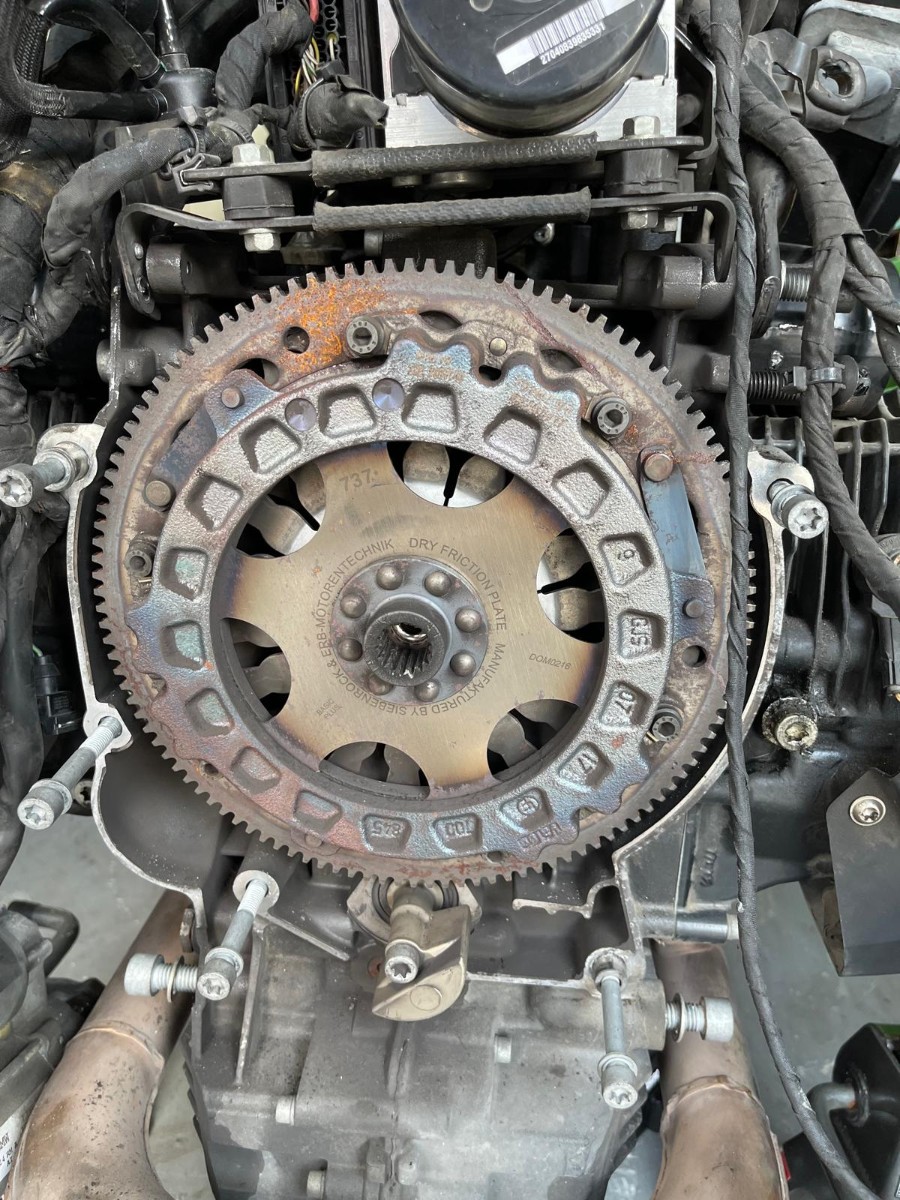

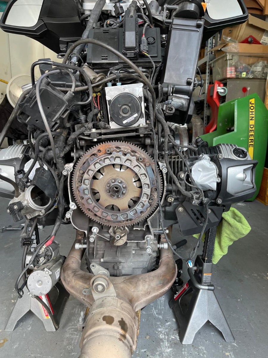

Finally found the courage and time to split the bike apart. While I was taking it apart, I felt that I was the first one pulling clutch out. My dilemma is as follow:
I purchased this bike from a City fleet auction. It was advised that the clutch was replaced recently therefore the bid went up high. I drove the bike a total of 3-4 times and it lost power (engine sounded good) and some coming out of tranny area. Before opening it, I file for FOIA request from the city and acquired repair receipts. The documentation showed that the clutch was replaced at 11000 miles and I purchased the bike at 22000 miles. I now suspect that the outside repair facility just charges the city loads of money but never replaced the clutch. Can any gurus here advise what to look for, lets say, if the work was never done and it has original clutch? adding pictures for you guys.

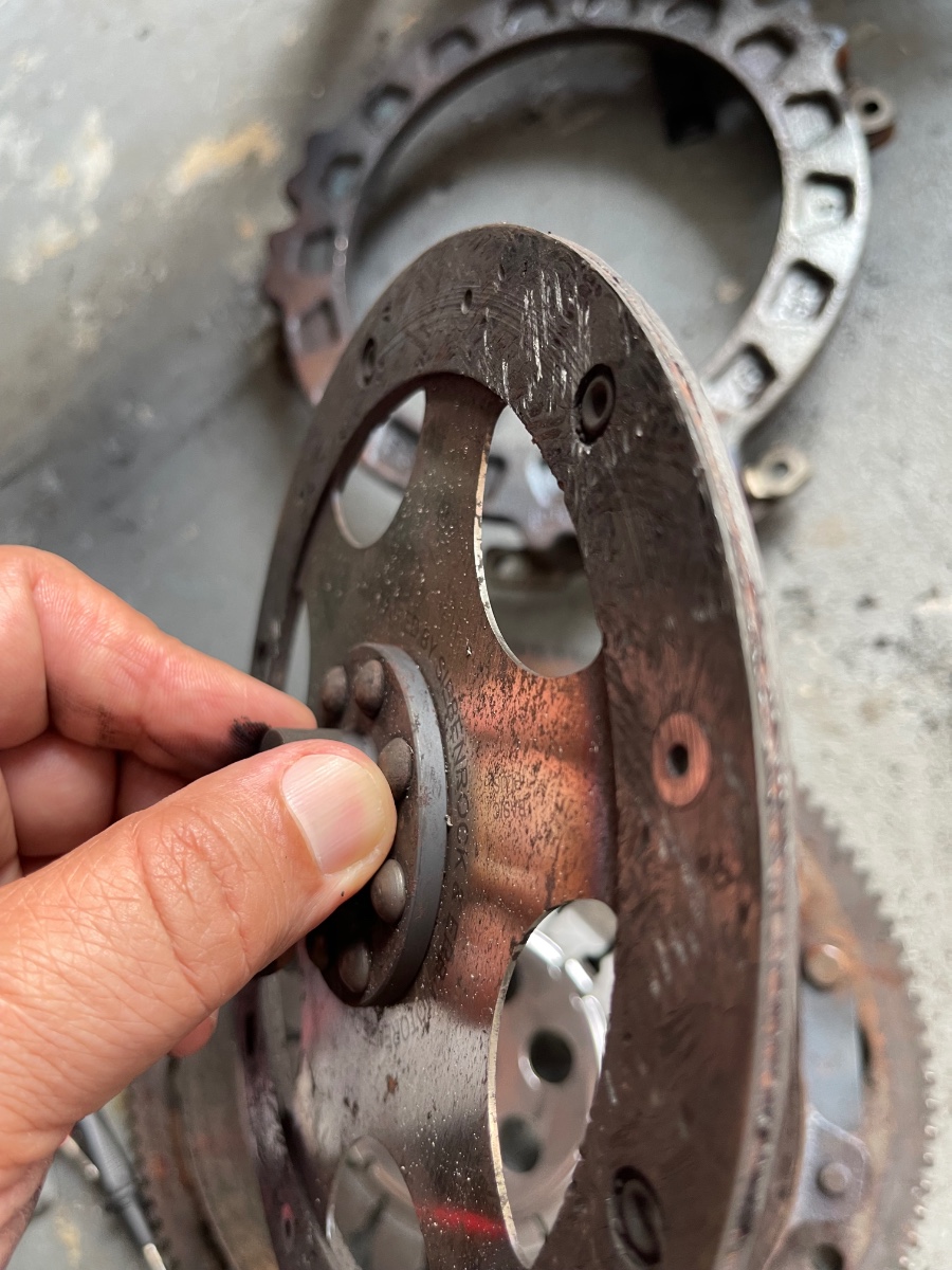

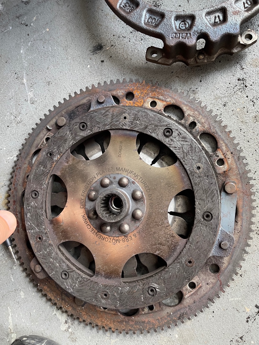

Its a single dry plate. Attached pictures show clutch plate with pressure plate and housing cover sitting aside. The other picture shows the condition of the clutch plate.
I purchased a CLA02600 kit from Beemershop along with new bolts for half the price. Ive searched the internet for correct torque for all the bolts unsuccessfully. Does anyone here knows where to find the torque specifications for all the bolts. Another dilemma is whether to replace the seals or just leave them since they have worked and looked fine. Bike has 22K and this is second clutch replacement. City replaced it at 11K and sold the bike in auction. I blame the previous rider because these bike can do better; I know.
