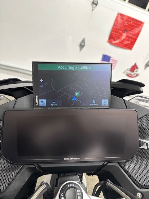

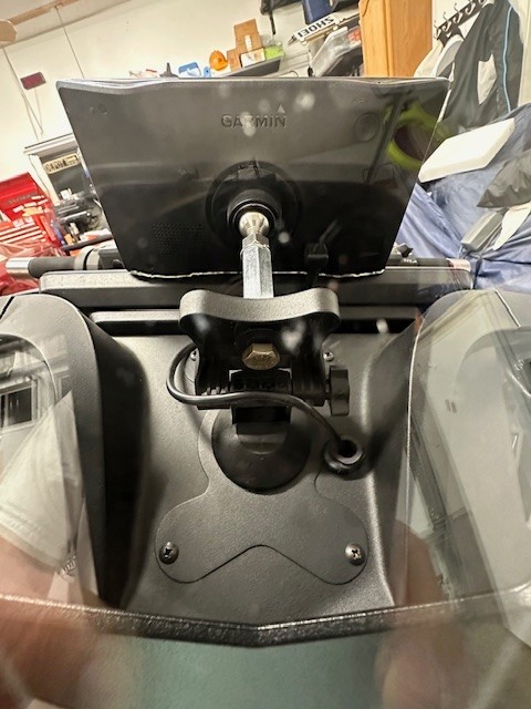

I bought this one. Plugged into radio under seat no problem. Mounted on top of saddlebag w/ Dual Lok.
https://www.amazon.com/gp/product/B091K ... UTF8&psc=1
Removed OEM ant. Started w/ this thread:
https://www.bmwlt.com/threads/2021-22-r ... st-1984003
While not a complete step by step guide, it's helpful. Have anything you intend to mount in the orig. XM ant. location at hand so you can do that while it's apart.
I repurposed a monitor mount I had lying around for a relatively cheap 7" Garmin.
Good luck, take your time. Patience is important in removing/replacing the panels.
