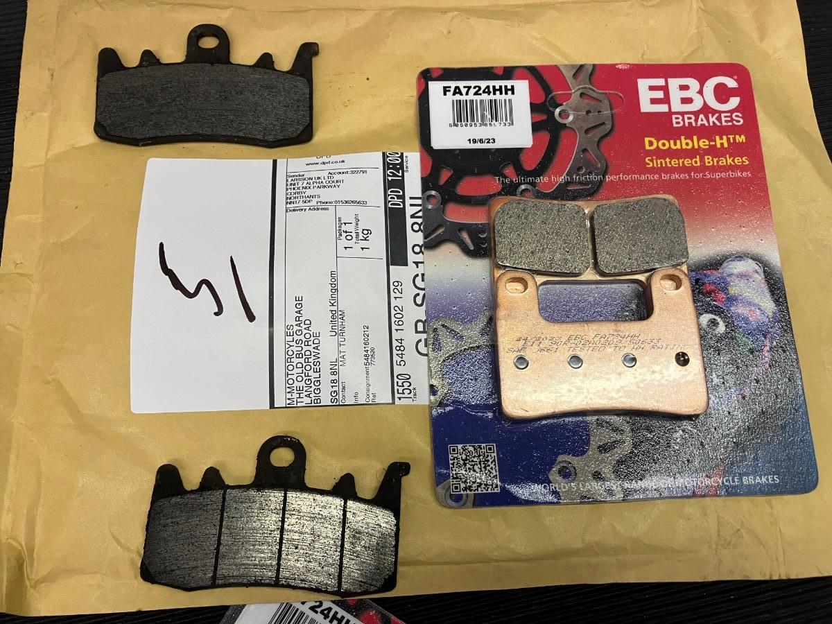

Hi all,
So need new front pads, ordered what was listed on our friend Nippy’s site as for my bike, but went to fit, nothing like it!
Simple question that seems hard to determine, what is the EBC equivalent?
BMW stealer only had original or brembo part numbers, couldn’t help with EBC.
All listings I can find only seem to be for the same as in photo.
I can’t believe that someone on here hasn’t come across this, hence my asking….
Thanks in advance
Re: EBC part number, 2022 R1250RT, front, Brembo callipers
FA724HH is the part number for my 2019 R1250RT front pads.
EDIT..
Hold on, mind does not have the Brembo front calipers......
I think you have been sent pads for the 2019 to 2020 R1250RT.
Your old pads look like EBC FA630HH
Post by BikerBill21 »
Some did, before BMW switched to brembo, hence the problem trying to find pads. Mine came with the gold brembo callipers….
BikerBill21
Posts: 11
Joined: Sun Oct 10, 2021 4:33 pm
Bike Model and Year: 2022 RT
Found them….go to
https://www.motorworks.co.uk/catalogse ... ?q=FA630HH
…and you will find a range of compatible pads, all referenced against the part number that BMW gave me for these pads,
34118548028.
Hope this helps others …
