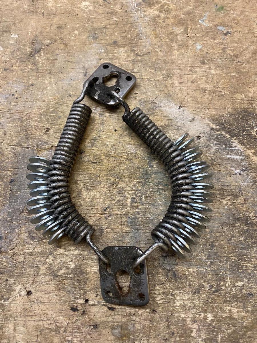

Some may mock, but the multiple washer method worked an absolute treat for me. Photo shows it just after I had removed it and prior to cleaning.
:cheers:
No blood was sacrificed during this process, which is a rarity…
