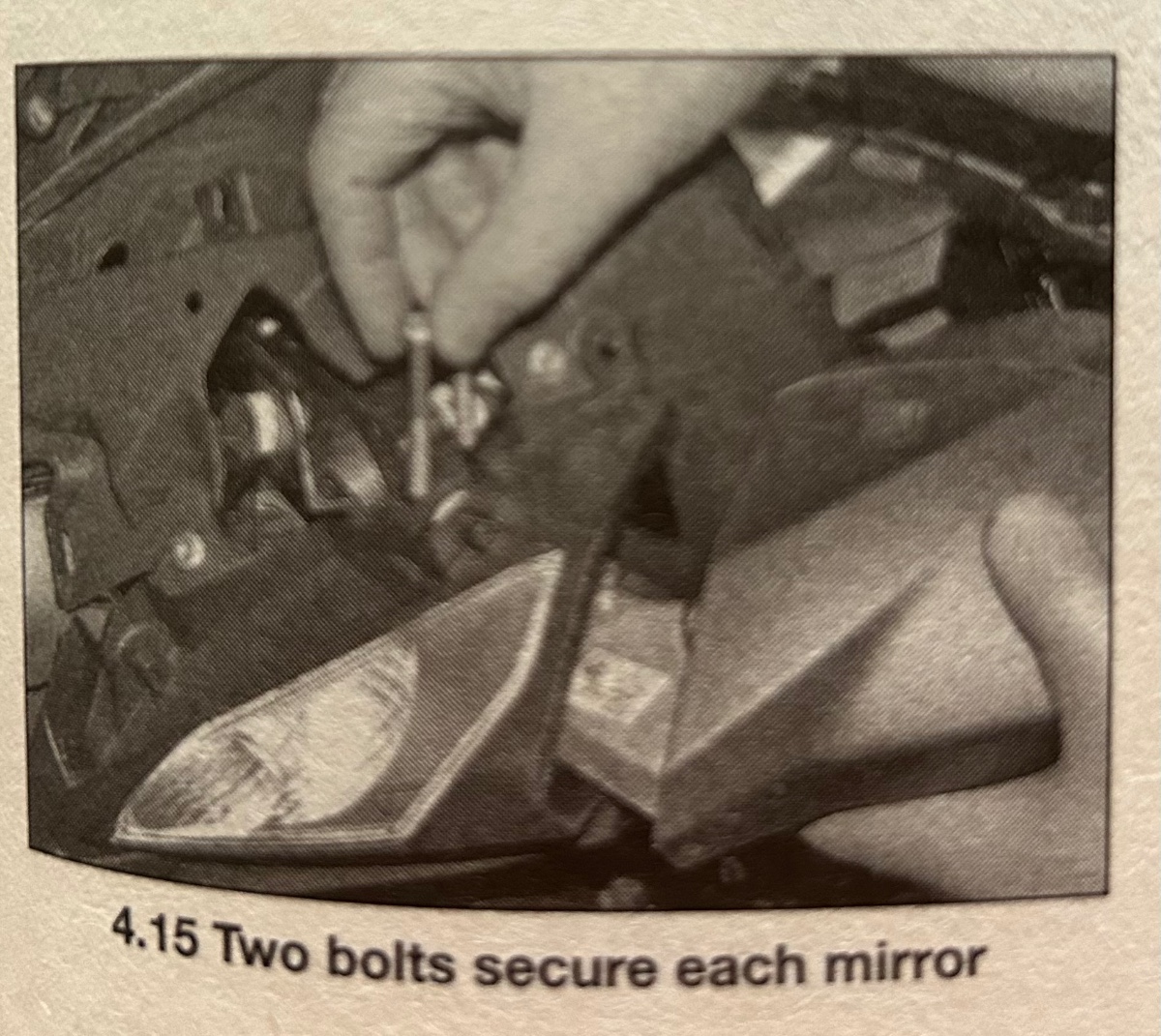

From Haynes manual.
Re: Mirror cover replacement
The back of the housing just slides off
You have to give it a good tug but it just slides out
