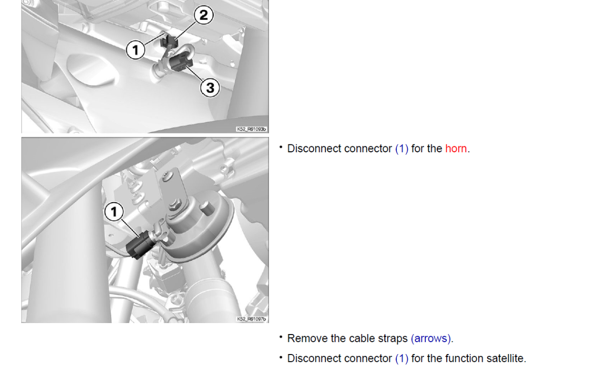

Re: 2018 1200RT Police
Just looked in the service manual and that doesn't really show anything either
