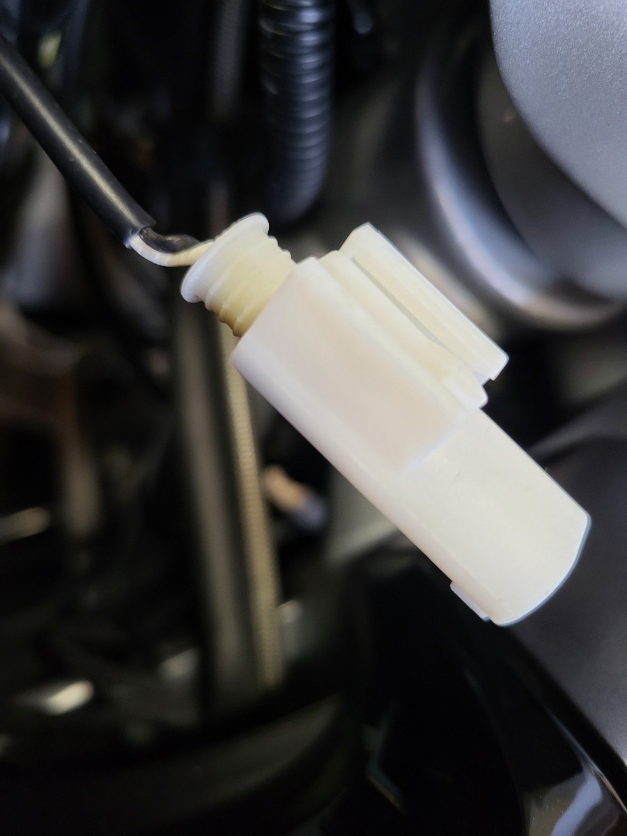

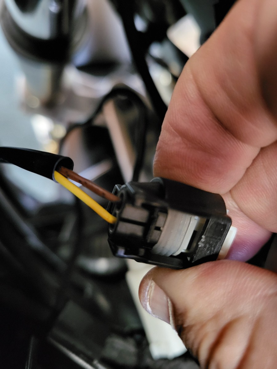

Hi guys,
Sorry if this has been asked before, but I have a question about the gps connector which is found below the left hand bar. When I pulled the two parts apart I was expecting to see a red and a black wire. But what I actually have is a yellow and brown on one side of the connector and white and black on the other side.
I have attached a couple of photos, but I am wondering now if this is the right connector?
My bike is a 2022 model.
Any advice would be much appreciated.
Cheers
Chris
One half of the connector

The other half of the connector
connector 1.jpg (203.24 KiB) Viewed 1355 times

Looks like the wrong connector, the one for the gps only has one side with wires going into it and a blanking cap on the other side. I think the connector you have is the one that is cable tied to the inside of the left fairing.
This YouTube video shows where it is,
