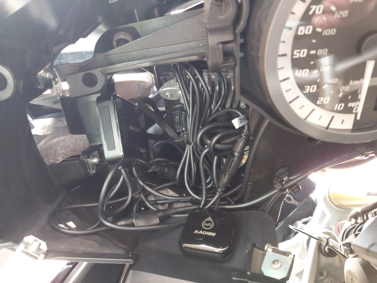

So my Innovv K7 is all fitted and working.
It cost me £300 for the K7 system and £35 (rip off) for the front camera bracket
I have a Hex EasyCan fitted but did not connect the K7 to it.
I have a fuse box behind the right speaker cover so ran it from there.
The fuse box works off the delay off switch live under the seat.

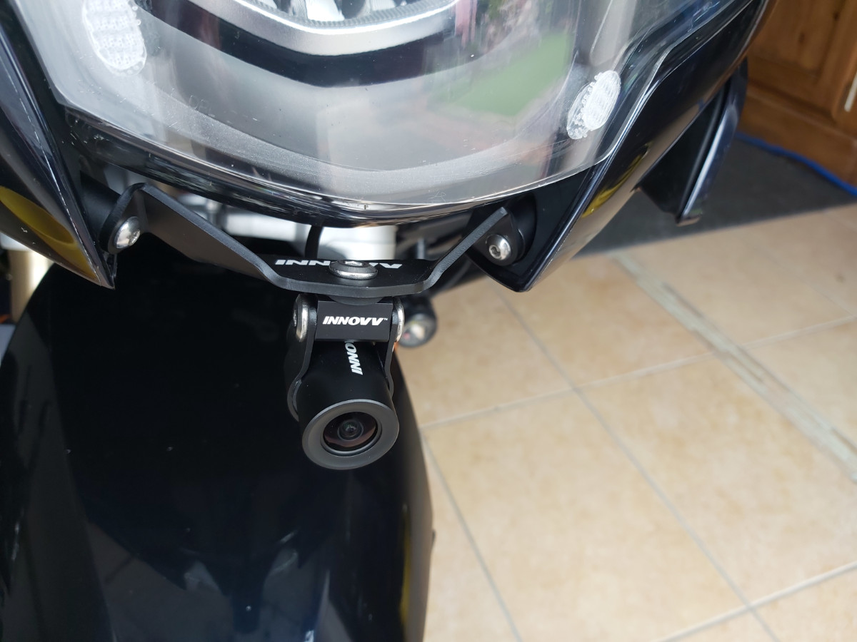

So i have one camera under the headlight fixed to the innovv bracket.

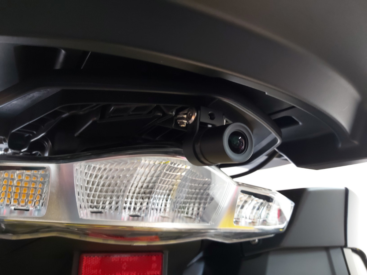

The rear camera is fixed to the underside of the top box rack.
Now to keep the system away from as much heat as possible, i have the main unit fitted behind the left speaker cover.
Doing it this way there is more airflow than under the seat and removing the micro sd card is easy.
The 2m cable for the rear camera is just long enough, running along the top of the subframe and over the fuel tank.
The GPS unit is fitted to the left side cubby box just out of sight under the speaker cover.

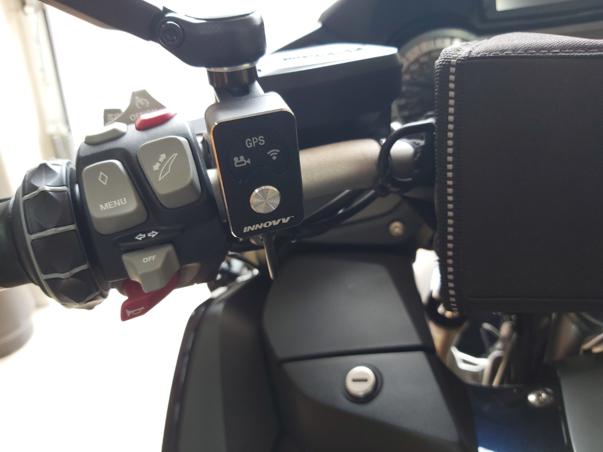

As i have the GS handlebars i was able to fit the remote control to the mirror mount
I did not use the mic as i did not think it was needed.
The cables look a bit of a mess behind the speaker cover, but there all out of the way.

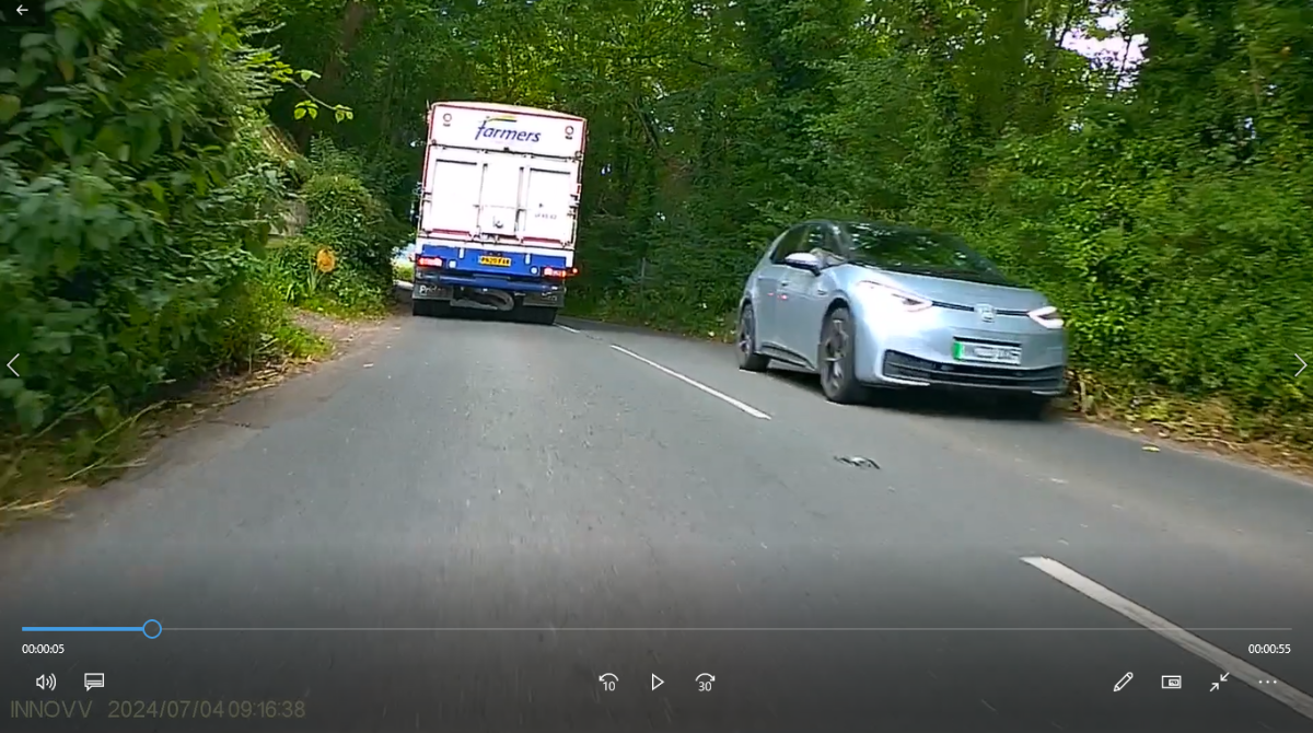

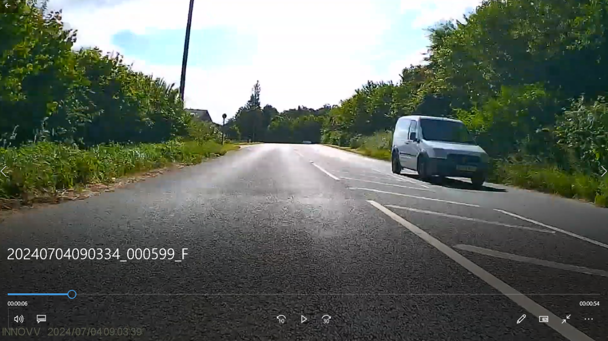

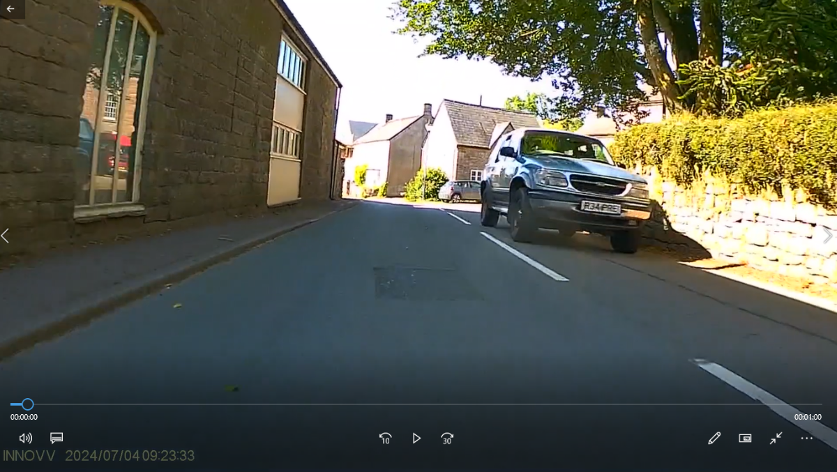

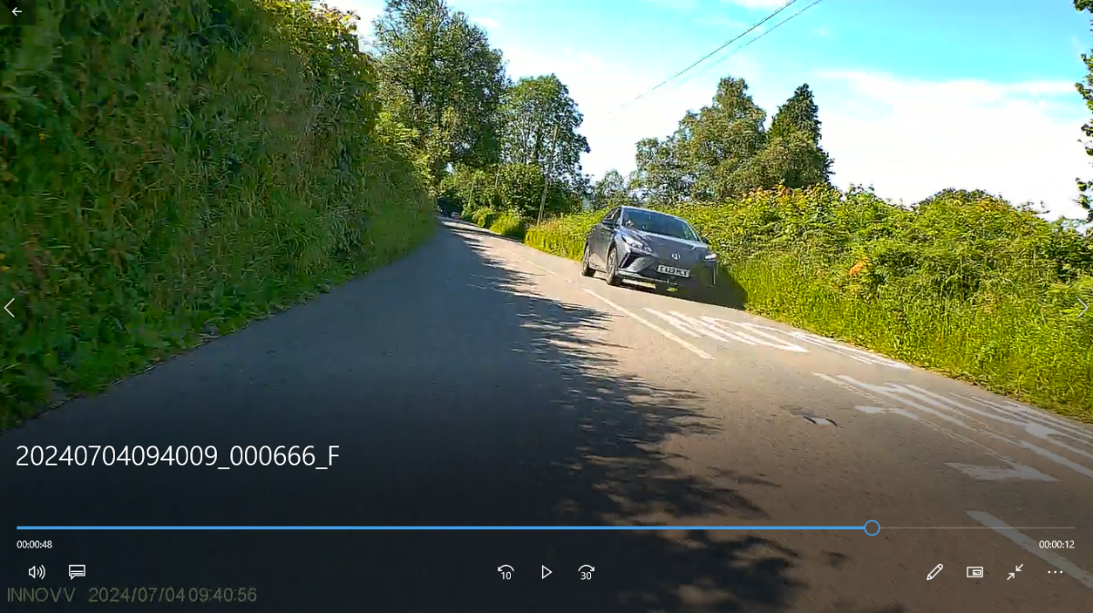

Here are some still screen shots. The one behind the lorry im am going very slow at i just turned in to the road.

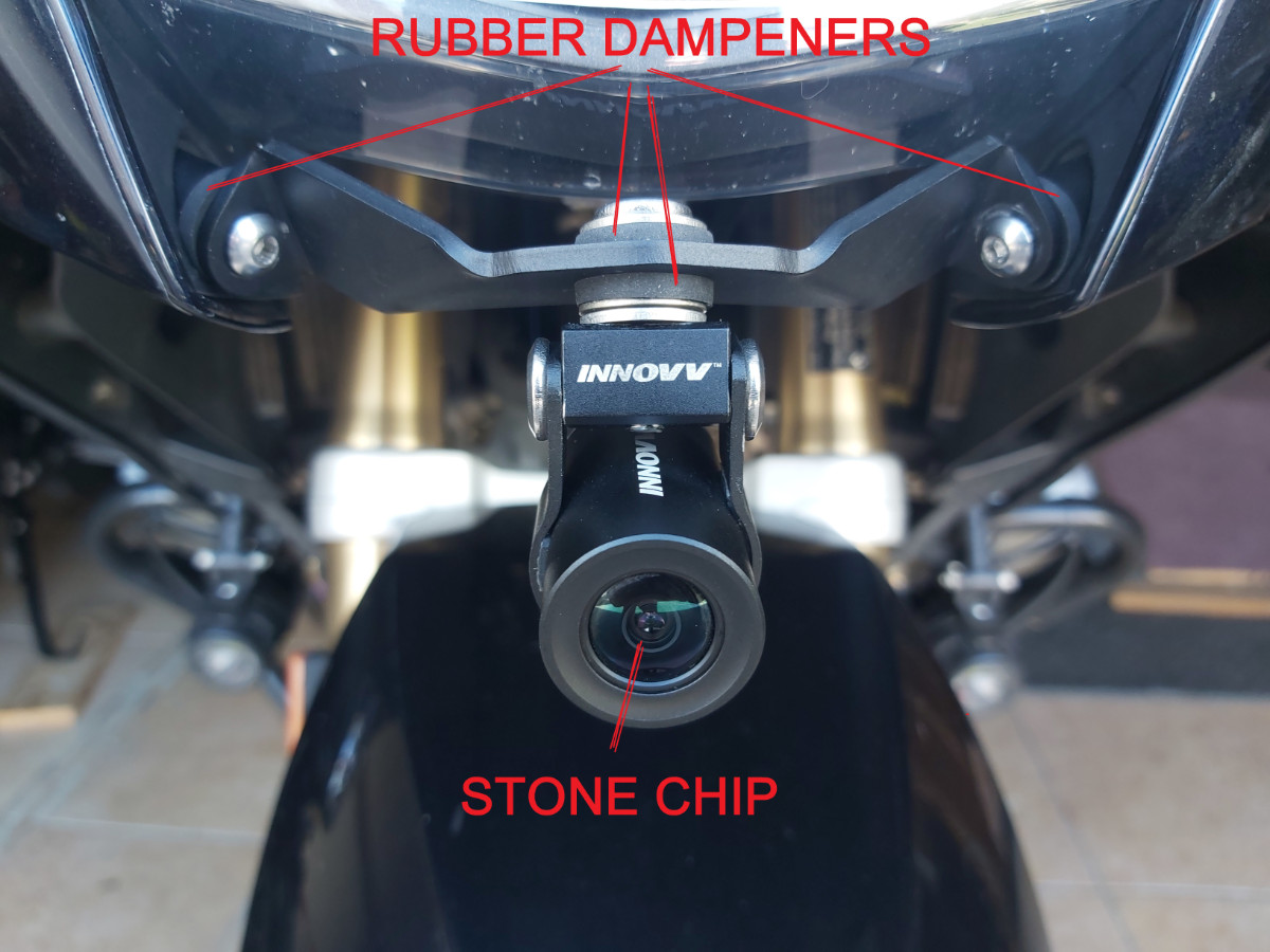

I am starting to think that the K7 is a bit more sensitive to the vibration of the boxer engine than the K3.
I have now added a couple more of the EDPM washers that come with the kit, between the main bracket and the side panels.
So i now have 3 EDPM washers fitted to the front camera mount.

Re: Innovv K7 now fitted
I'm starting to think this Innovv K7 was not the right system for Artie.
I just added some extra dampener to the mounting bracket.
I then saw it, a bloody small stone chip in the middle of the lens.
I checked the last of the footage just before i got home, and luckly you cant see it.
So now i cant send it back.

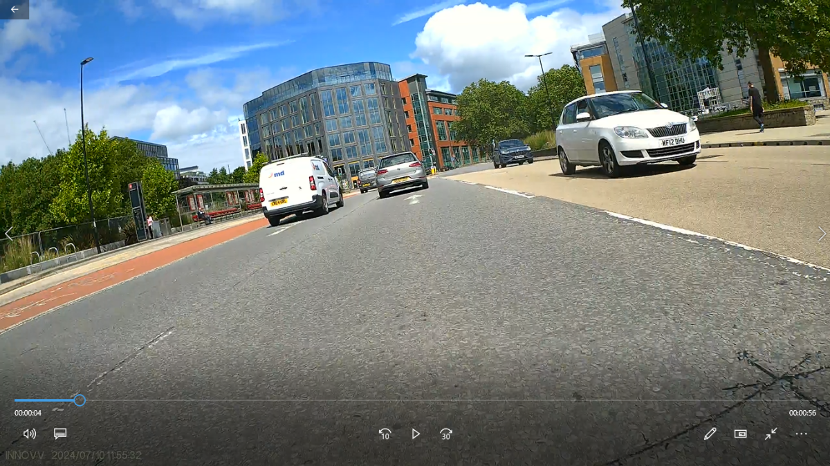

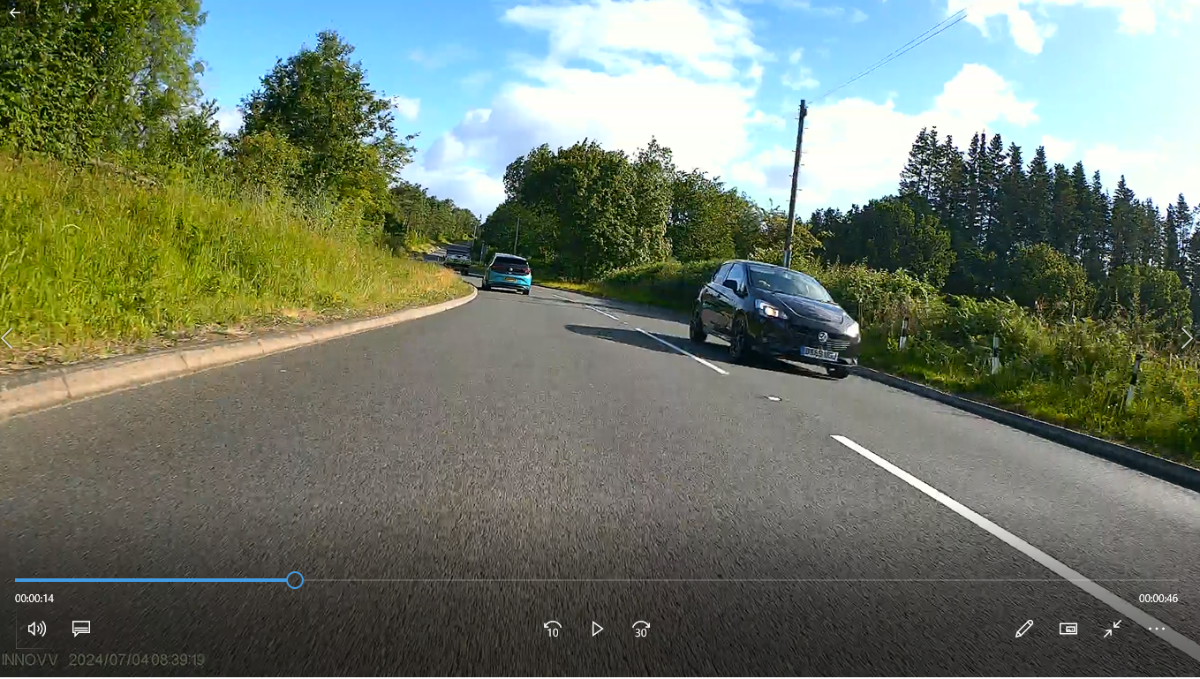

Happy Days. Adding the extra rubber mounts has worked. The video is much better than it was.
So now i'm happy with it. The still photo is much better. This is at 30mph.
