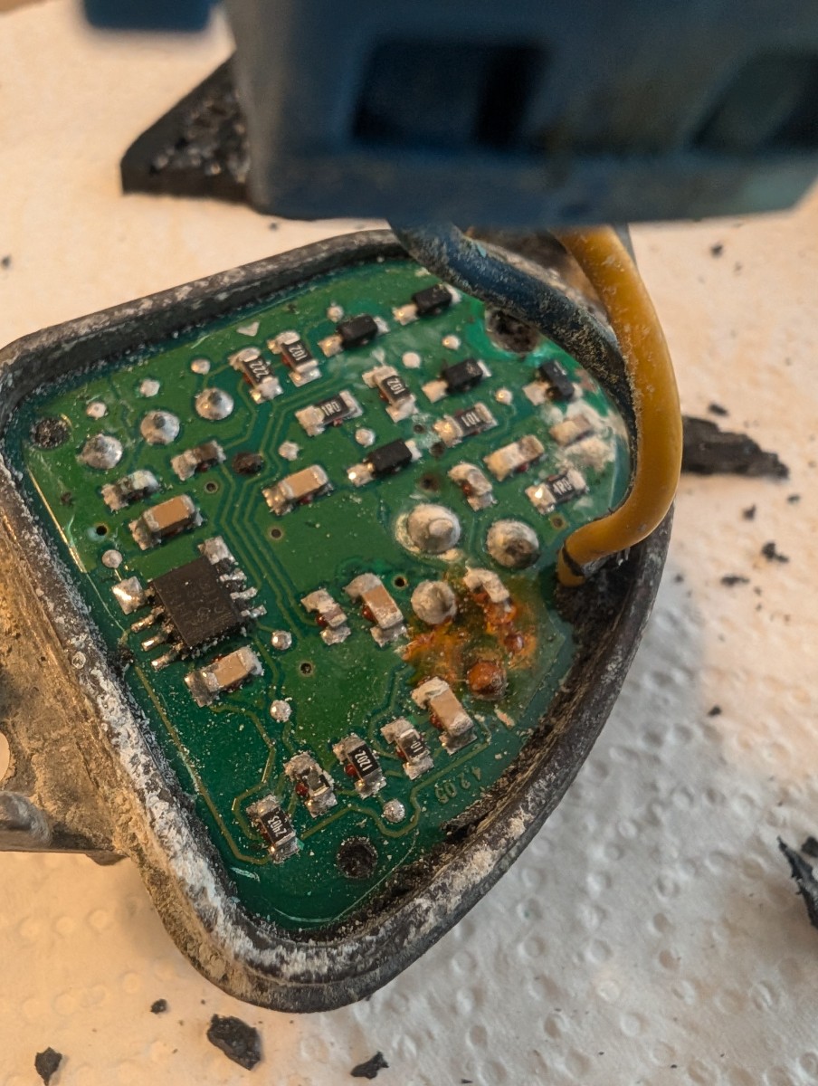

This turned out of corroded fuel pump controller, the bmw service also changed fuel pump as well. Now everything works as expected.

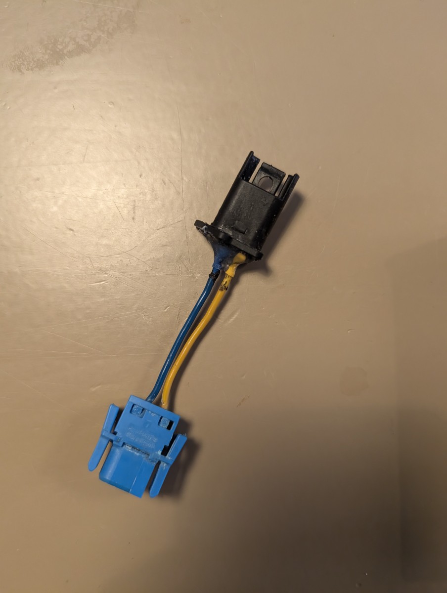

I have also made myself a bypass cable from the remains of the corroded controller
