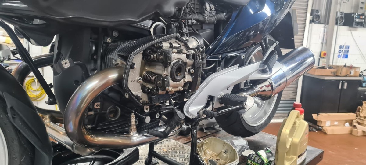

Me too, supplied by myself, fitted by a BMW dealer, inc. Castrol engine oil & Liqui Moly gearbox/final drive oil.
Oil & Filter.JPG (15.37 KiB) Viewed 2893 times
Liqui Moly.JPG (3.87 KiB) Viewed 2890 times
