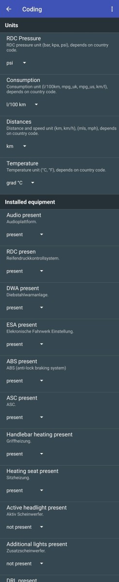

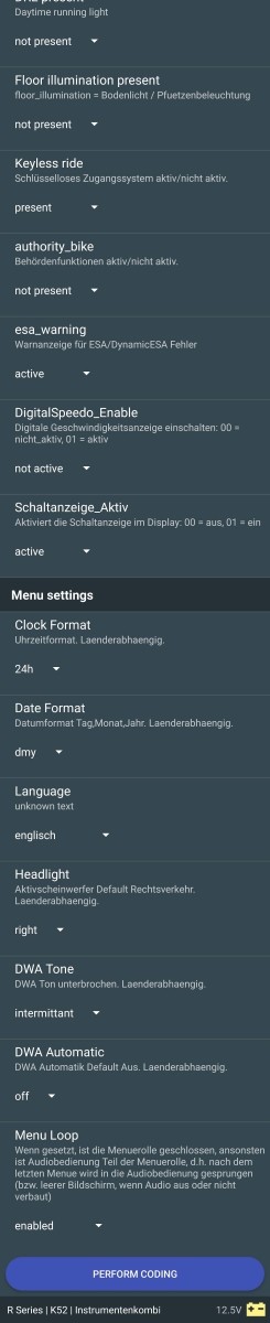

- I could have messed a cluster (KOMBI) config while playing with the "Moto Scan" application
I've double checked my kombi config options (see included screenshot) and can't see if I would have put something wrong... I could buy a new cradle but it's a random test... Otherwise I guess my next try would be to bring it to the dealer...
