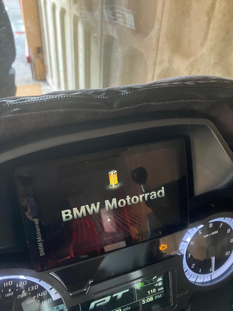

Acquired a Nav VI separate to my bike, put it on the bike and it showed the battery icon. Thought it just needs to get enough juice in to turn on if it’s been off a while.
After 2 hours of riding, still showing the battery symbol with a ? mark in it. Don’t have a manual (any links available?), so could anyone shed any light on this?

Re: Nav VI not happy
Try plugging it in to a wall charger for an hour or so? Failing that it looks like it might need a new battery.
I second the wall charger with at least a 2 amp power output

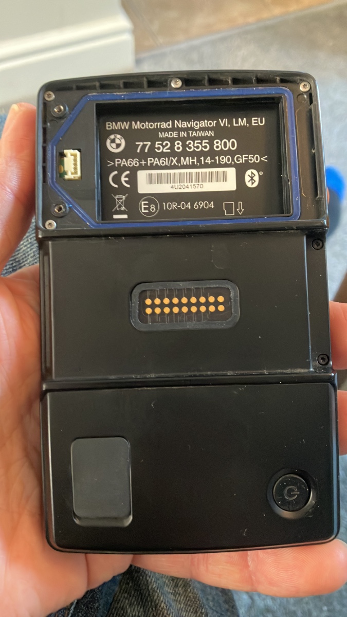

May have found the issue. Doesn't have one! :lol:
Post by lancashirert »
Not knocking that from Garmin either.

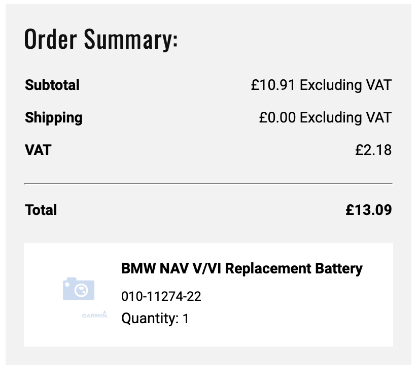

If you have only just bought the sat nav, contact the seller and see if you can get a part refund to cover the cost of the battery. If bought from ebay, open a case up because you were not told it had no battery.
lancashirert
Posts: 83
Has liked: 39 times
Been liked: 20 times
I got it completely free, basically because it “might not work” I’m not grumbling!
