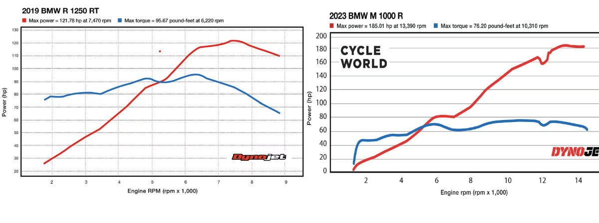

MotorcycleMEB wrote: Sun Sep 01, 2024 5:45 pm The BMW guy who sold me it said that he keeps it between 4500 and 6000.
What a load of codswallop when talking about an R1250RT. Keeping to mid revs might be the case for a M1000 something, Fireblade or R1, but look at what your riding, the RT is a big torquey engined twin. The torque curve of an RT shows monsterous amounts of grunt from from low down and in fact torque peaks at just over 6000prm. That means the thing pulls like a steam train and you don't need to rev it for day to day riding. Compare that to the the torque curve of the M1000R, they make less torque, but look at the BHP curve at mid revs. Drop an M1000 down a gear and your right into the steep part of the big rise in BHP for instant rev, rev, rev through the gears, which is what the M1000 is all about. Nope, ride the RT using the torque and you'll be suprised at how easily a small twist of the trottle will propel you forwards or pull you out of corners.
