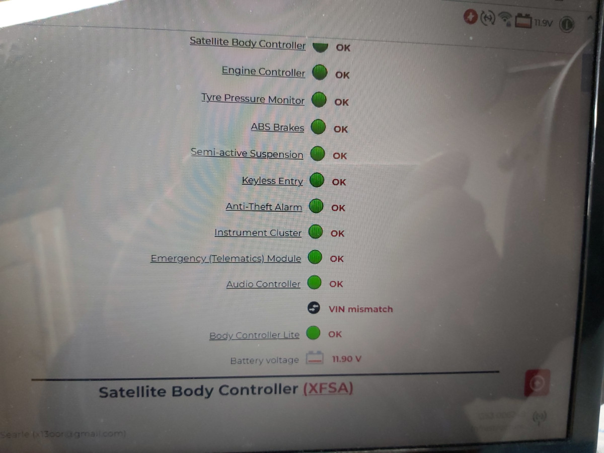

I just did a scan with my GS911, no faults with the audio system. It does however comes up with "VIN Mismatch".
I will ring up my local BMW dealer today and ask about it.
Also i have read that MotoScan might be able to code it, anyone know anything about this ?

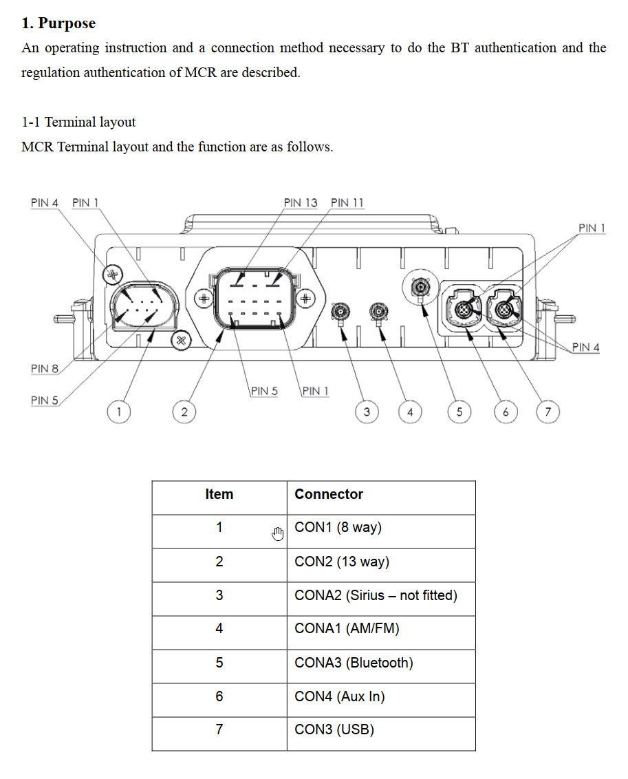

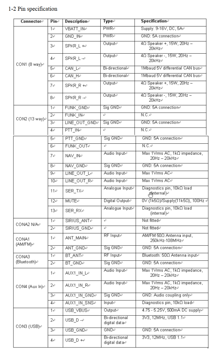

With my hunting for wiring info on the audio system, i came across this. It might be helpful to others.

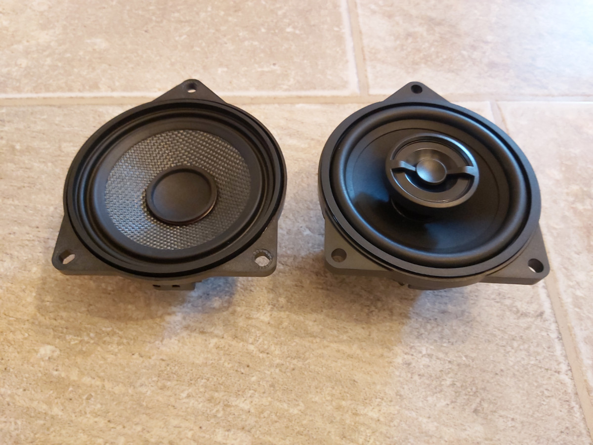

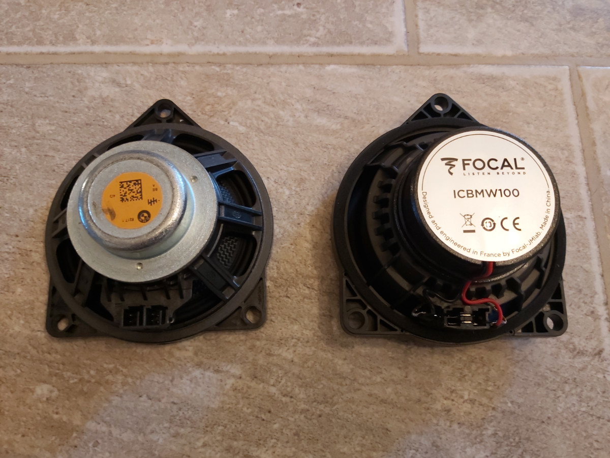

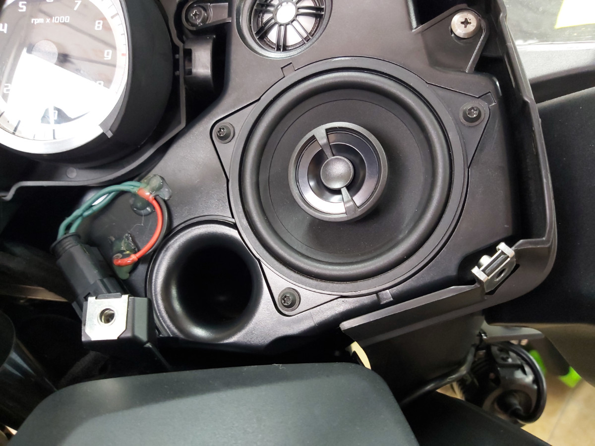

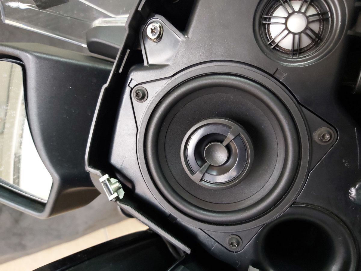

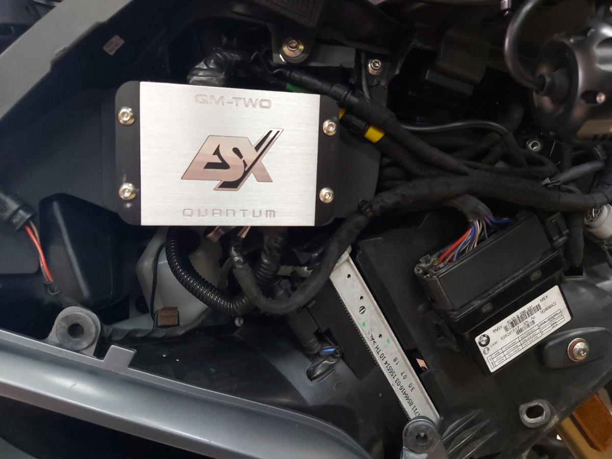

So i have now finished all my audio system to improve it over the OEM stock system.
It now has DAB radio, and i can get a load more stations now.
I replaced the speakers for some Focal 40w RMS units that are OEM fit.
I have also fitted a mini 2ch Amp to up the wattage of the system.
When i'm ready to add a pair of rear speakers, I can put them in series.
So 2 x 4ohm speakers in series will become 8ohm. So not to draw to much power.
I can fit 5.25" speakers in the front and then use the 4" speakers in the rear.
The reason for doing the upgrade is to stop the clipping from the speakers.
Just need to brake the speakers in now to get the best from them.
