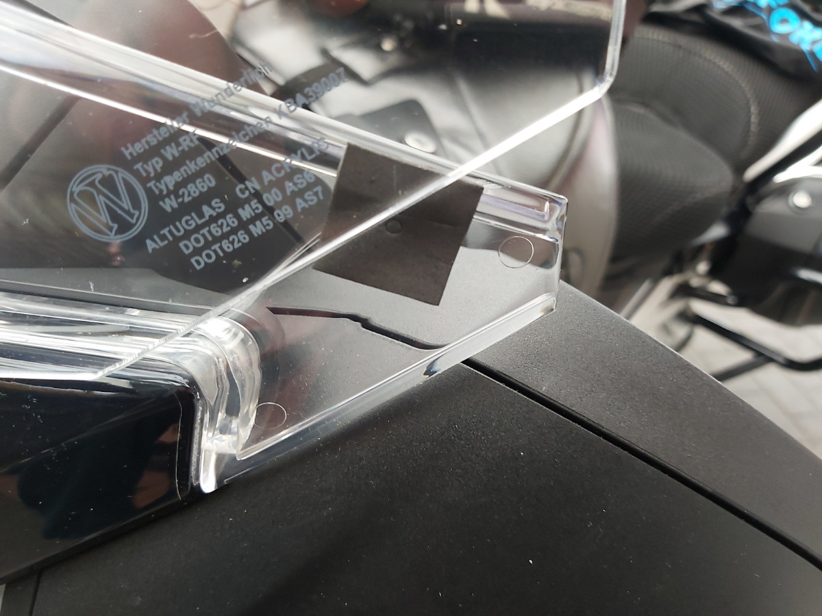

One problem I do have is the extended 'winglets' a the bottom of the screen touching the small pespex fairing deflectors. I put a 1/8inch rubber washer between the mounting bracket and the screen and that pushed the screen a tad further forward and fixed that, however I've since read elsewhere that W'lch have admitted that some screens can come out of the mould with a excessive curve. If you've got one I believe they'll replace it, but as I'd had mine for over two years by that point and the rubber washers fixed the problem I didn't bother contacting them. Overall I pretty happy with mine, but if you lived somewhere hot I think they'd be too big.

Once again Capt for the good info. Also when i fitted the screen i was not happy with it touching like it does when fitted.
I knew i had some little rubber foam pads in one of my draws in the workshop. 10 mins later problem sorted.
