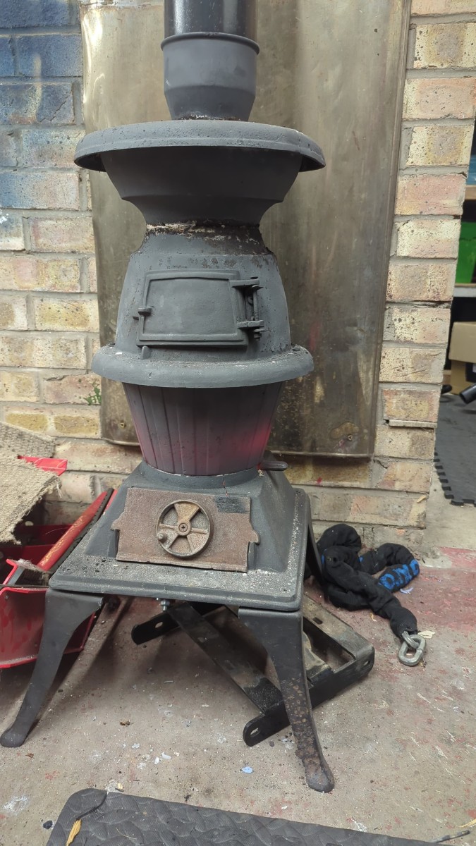

Not me!!
Thats why I have this bad boy :lol:

Stu wrote: Tue Nov 19, 2024 8:24 pm Not me!!
BAN,BAN,BAN
Didn't see that on the Nippy Norman's website...
