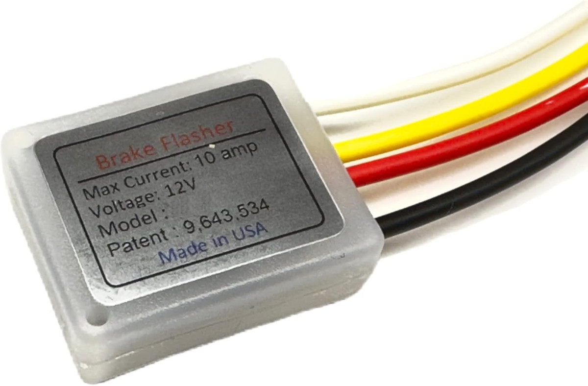

I've done this before on an FJR, and I'm sure the flashing brake light has saved me more times that I know!
Here's the unit I like.
I always get butterflies cutting into perfectly good factory wiring!

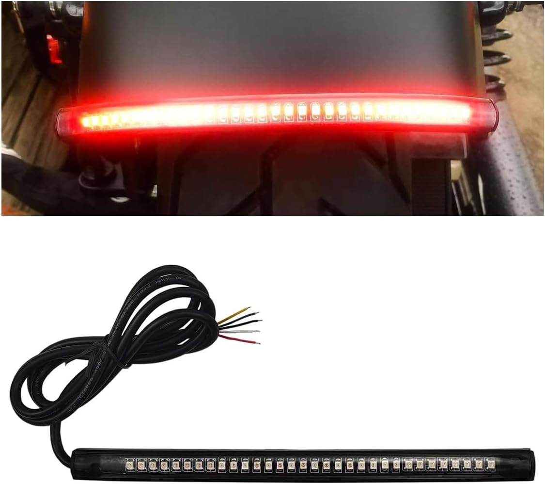

- The onboard computer did not tolerate the flashing chip! It gave the same warning it would give if a bulb were blown.
- The H7 LED replacement bulbs were clearly NOT a replacement for the incandescent bulbs the bike has. (Amazon's "does this fit my vehicle" failed me in this case.)
- I soldered in all the wires needed to drive the stop/turn signal light bar I plan to add just above the license plate.
- The flasher unit will drive that LED strip without interfering with the extant incandescent stuff the bike has. (I hope).
Routing the wiring from under the back seat to the light bars will not be that difficult, and that maybe be the only hole I drill completely out of view.
It would be UN WISE to drive in California stop and go freeway traffic without a good flashing brake light!
More posts and pictures later.
