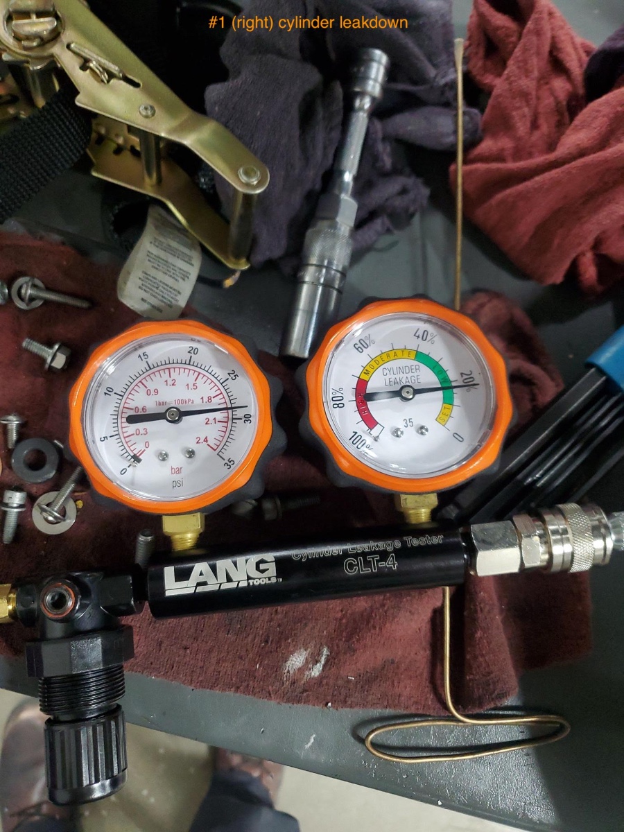

I own a 2009 BMW R1200RT with 95k miles on it. In that 95k miles, I've lost performance and fuel economy twice. This is to stay that on two occasions that engine failed compression and leakdown tests. The last time, it made 150 lbs. compression with 9% and 11% leakdown in each cylinder. So, I love this motorcycle, and I want to save it. I'm tired of putting new rings in it, only for them to fail in 20k miles.

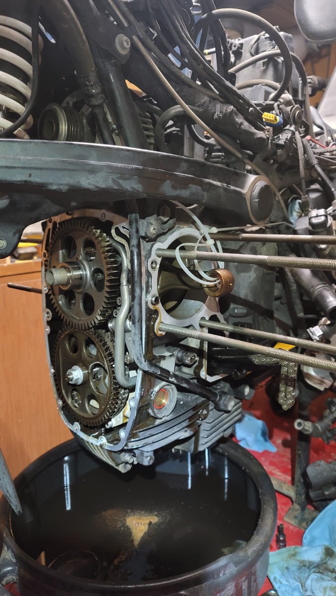

Well, the machine shop removed the brass plug that blocks the oil galleries on the #1 cylinder (right-hand side). They even drilled and tapped the hole that remained. I didn't recall removing any fastener from the hole, and I reserved myself to the fact that I would find it as I reassembled the bike. Well, I found out what was missing very quickly when I started the bike up, and it gushed oil all over my lift.
I didn't want to tear the bike back apart and waste $1500 for new gaskets and o-rings, so I plugged the hole with a screw, crush washer, and some red threadlocker.

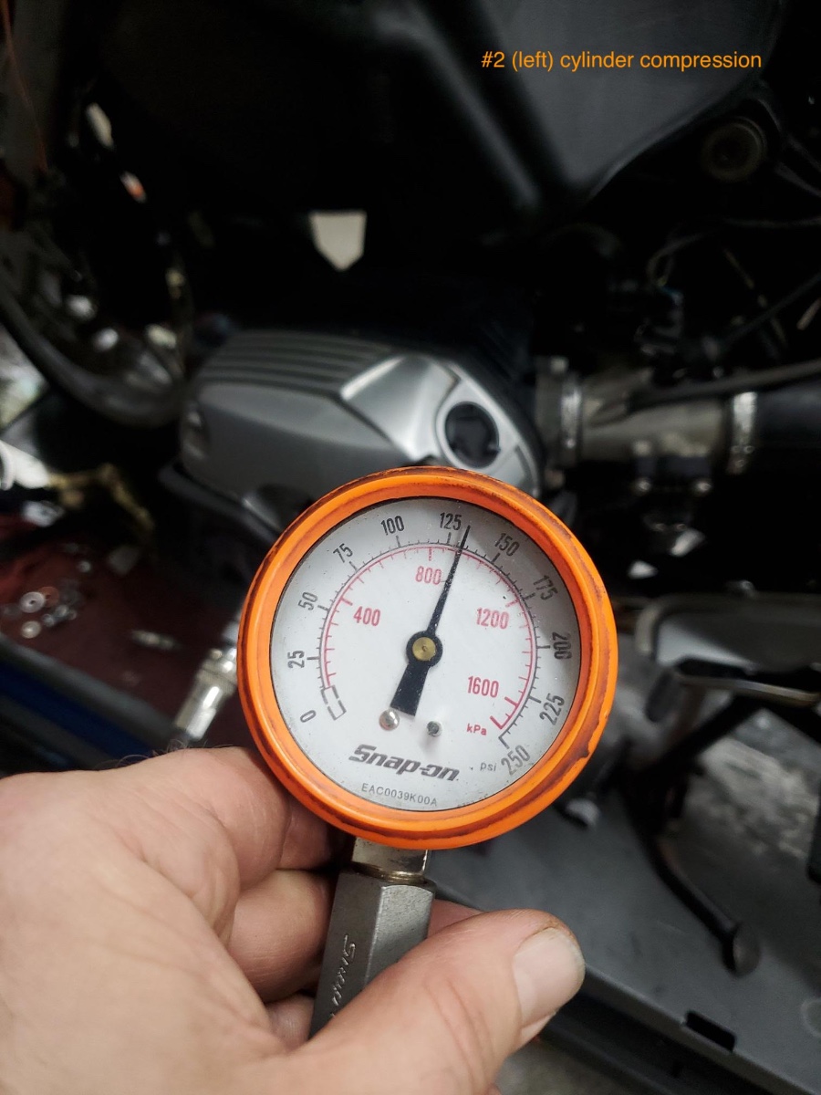

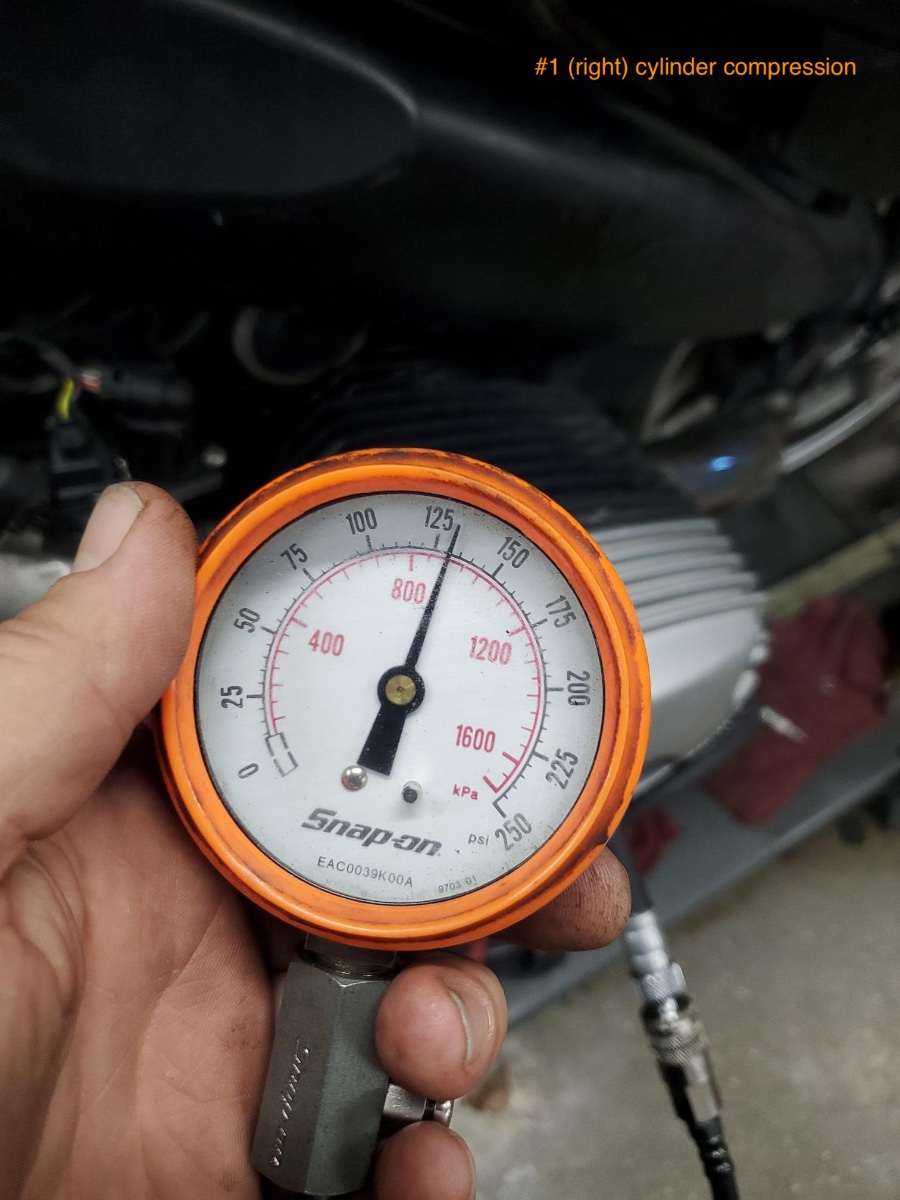

Anyways, I break-in the new top-end only to discover that the bike is more of a dog than it was before. A compression and leakdown test proved that the bike now makes 130 lbs. compression and 10% and 20% leakdown. It's worse than it was before with a brand new top-end! I'm livid!

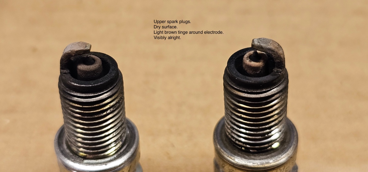

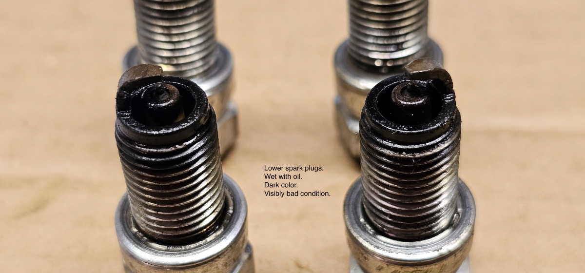

When I tore the top-end apart again, the bottom spark plug was wet with oil.

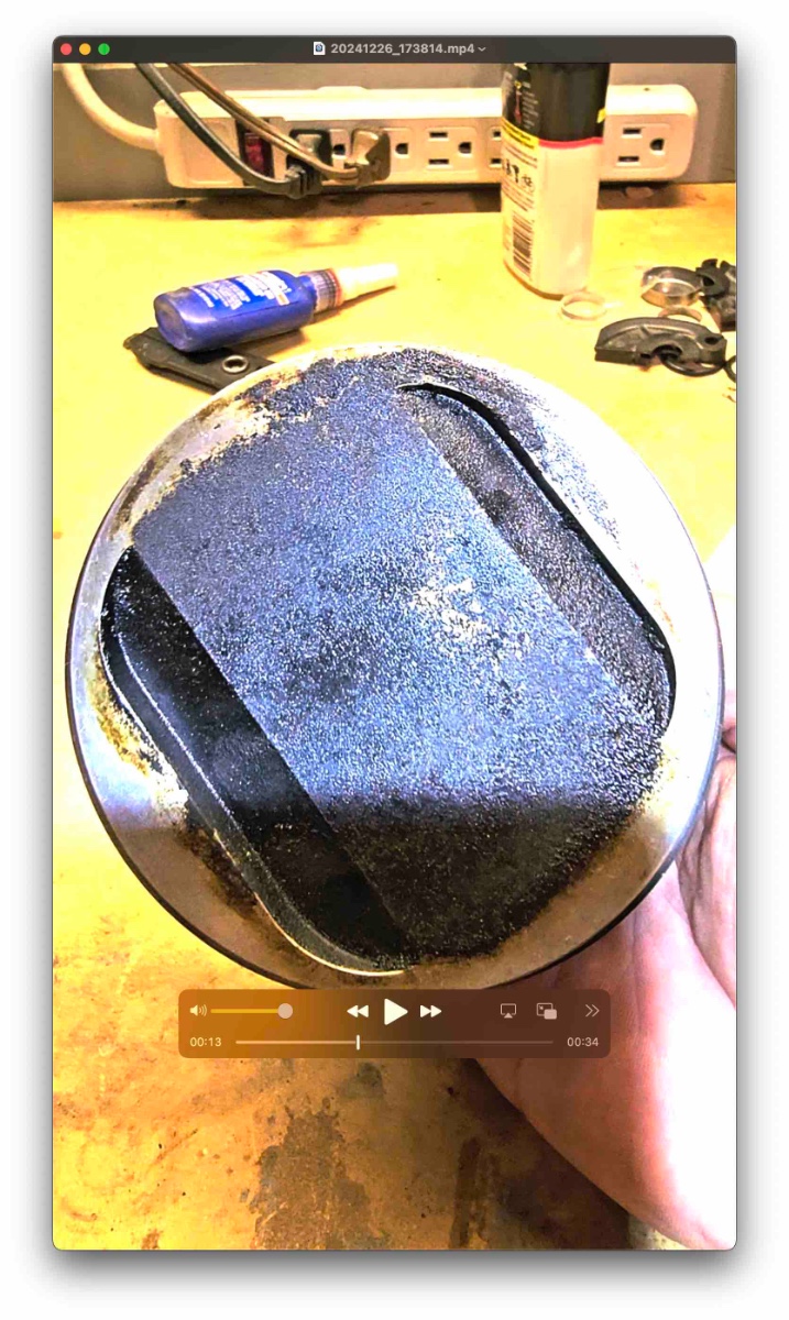

As I dug deeper, the exhaust valve is coated with burnt carbon. There is no sign of any oil that has bypassed the valve seals. The head gasket is fully intact and looks brand new because it is brand new. There was a puddle of oil in the combustion chamber sitting at the bottom of the piston where it meets the bore. The top of the piston is coated with oil-soaked carbon and has a nice film of oil all over it.
There is a bit of wear on the bottom of the bore from the piston skirt.
The pistons appear to look fine. The top ring looks like it sealed evenly and completely across the bore. The second ring is worn about halfway across the bottom, e.g. if you hold the ring horizontally, only the bottom half of the ring shows wear.

A cylinder compression of 130 psi is within the "normal" range of 125 to 145 psi.

It is usable for the bottom spark plugs to look more sooty. It left on the side stand for a while they can also become slightly oily
