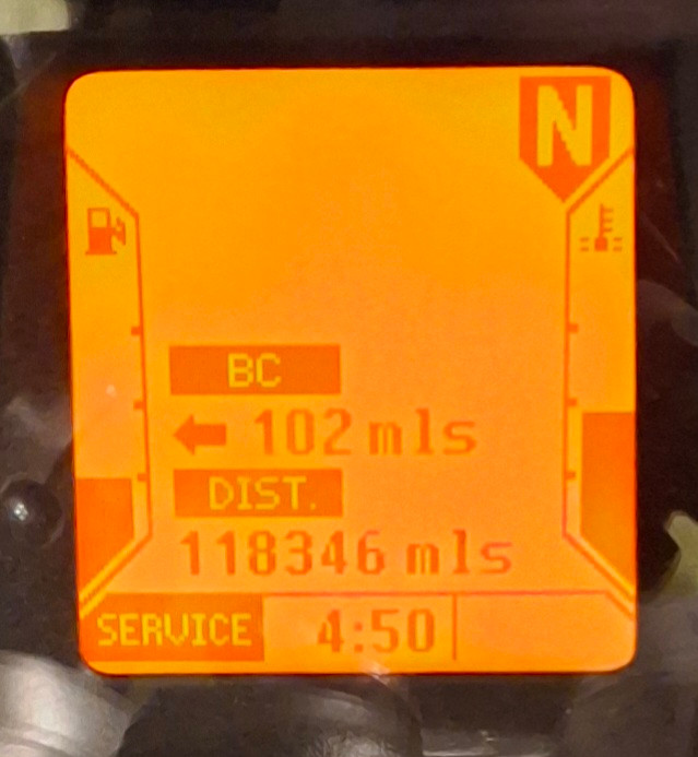

My BMW is trying to sendme a message!
Lower left corner, it says "SERVICE'... I'm guessing this means something needs service. I've changed the oil, oil filter, final drive oil, this month.
What needs service?
How does one turn the message off? ... (legitimately)
This is all new to me!

I found this in the "Owner's" manual (not the Clymer full service manual) .... chpt 11 page 159 showing
The service-due indicator in the multifunction display reminds you
about one month or 1000 km in advance when the time for a
service is approaching, on the basis of the programmed values.
or manual page 8/137 says ...
If the battery was disconnected from the motorcycle
for a prolonged period of timeit will be necessary to enter the
current date in the instrument panel, in order to ensure that the
service-due indicator functions correctly.
If you want to have the date set consult a specialist workshop,
preferably an authorised BMW Motorrad dealer
OK, I think I get it. The Service message is a reminder that I may need service.... but it doesn't tell me what needs doing..., and there's no way for an owner to reset the warning to make it go away?
Do I really need to take this in to a BMW dealer?
What do you do when this message appears?

Re: sending a Message!
you can use the GS-911 or the motoscan app to reset the service light
They aren't there to tell you what needs to be serviced! just that it needs a service based on 6000 miles (10000 km) or annually
what needs to be serviced depends on the mileage and the service schedule and what was done at the last service

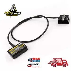

I found a device that proports to turn off the "Service" message.
https://www.ebay.com/itm/386854739325
(URL gathered 6 April 2025)
The other device, that does more, is $400. This one is $130.
I emailed a local BMW mechanic, and he charges $60 just to turn the message off.
(Hhhhhmmmm.... Would that make an oil change $60 cheaper or more expensive?)
In any case, it seems obvious that $130 is a better deal to be able to turn the message off on command.
That is.... IF it works.
I don't imagine, for a second, that I could get money back if it didn't.
Anyone used this device?
