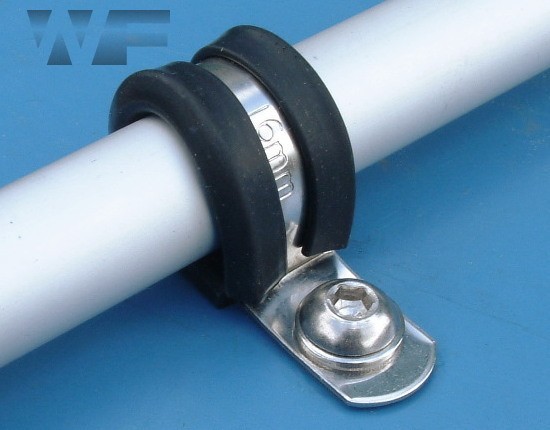

I've made a center stand protector for my Tiger 1050. I used a 2/3 mm ally sheet cut to size and used 4 P clips to attach it. I was surprised by how much crud i stopped. The P clips are like this.
