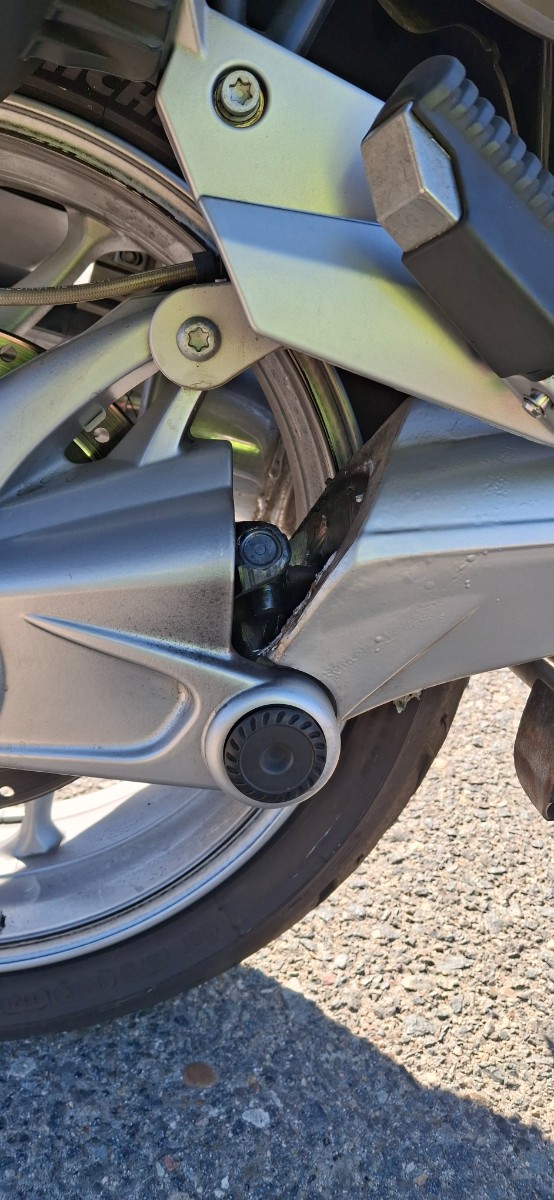

Here's a photo...
Ah, the joys of bmw shaft drives!!
A sudden huge rattling made me pull over. Smoke from the shaftdrive greeted me.
I had hoped it would last a little longer than a month.
Bought it used with 112,000 miles on it.
Caveat emptor!
Caveat emptor!
