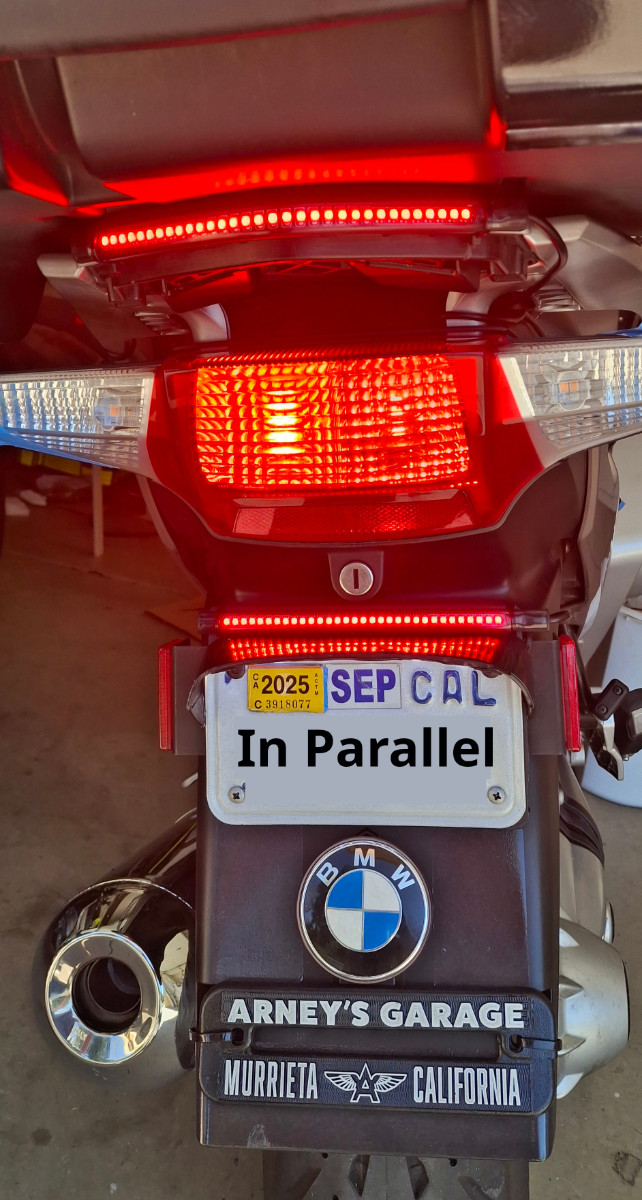

I'll start where I finished.. with the photo.
- wire3.jpg (248.15 KiB) Viewed 8658 times
- put new aluminium resistors in
- Everything worked (resistors got really hot just in the garage!)
- Added another LED strip along the trailing edge of the top box platform (will canbus tolerate that?)
- CanBus didn't mind
- stood back and thought about things for a long time
Adding the second led strip ABOVE the factory brake light made a big difference! With that in, did I really need LED bulbs in the factory tail light housing? Maybe, but NOT at the expense of peace.
There's NO peace riding along on a potential fire hazzard.
I decided to strip out BOTH RESISTORS and put in one 1156 standard incandescent mated with the one LED bulb that would work with CanBus. I tested those two early on looking for something that would work with CanBus and NO resistors. In the photo, that accounts for one side being brighter than the other inside the factory tail light. Now, I can roadside repair it by carrying two duplicate bulbs under the seat!
I could have put in two 1156, white, filament, incandescent bulbs... which is what was there to to start with.
The two LED strips, one at the top of the plate and the other on the top box platform, do a bang up job! ... AND.... there are NO resistors!
It would be visually better if one of the LED strips were completely OFF and came on only when I apply the brakes, but that's not possible.
