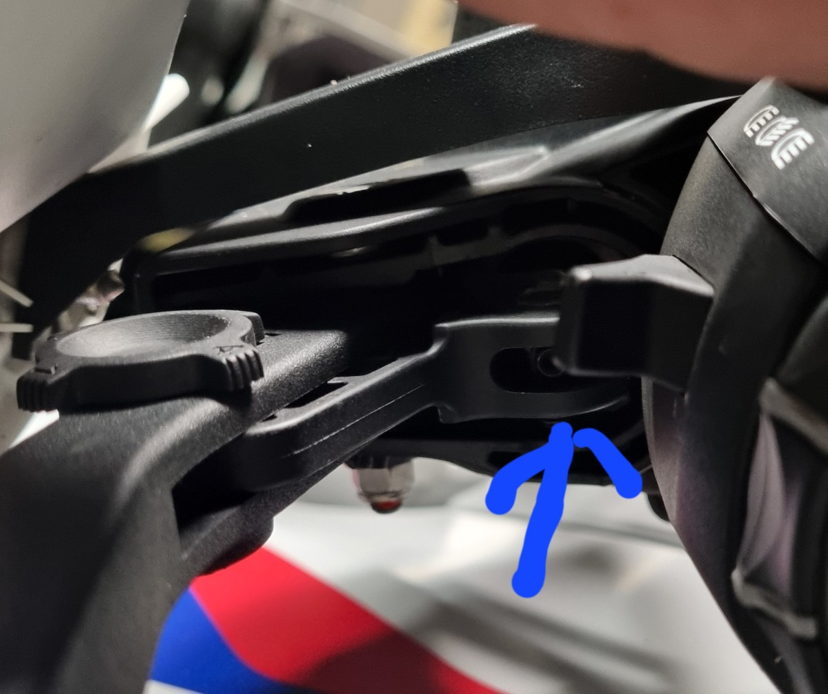

There's a little grub screw at the back of the lever you can adjust for the bite point, only turn it in small increments while checking the bite point you require.

simbo wrote: Mon Mar 24, 2025 5:08 pm There's a little grub screw at the back of the lever you can adjust for the bite point, only turn it in small increments while checking the bite point you require.
Unfortunately this doesn't move the point enough! well not in my case anyway
You are talking fractions of an inch and if you're not careful you can end up with clutch slip if adjusted too much

Stu wrote: Mon Mar 24, 2025 7:03 pm Unfortunately this doesn't move the point enough! well not in my case anyway
I was replying to the OP's question of "anyone have any experience of anything a little cheaper". It's worked for a few members of the ukgs forum so thought it might be worth mentioning. 👍

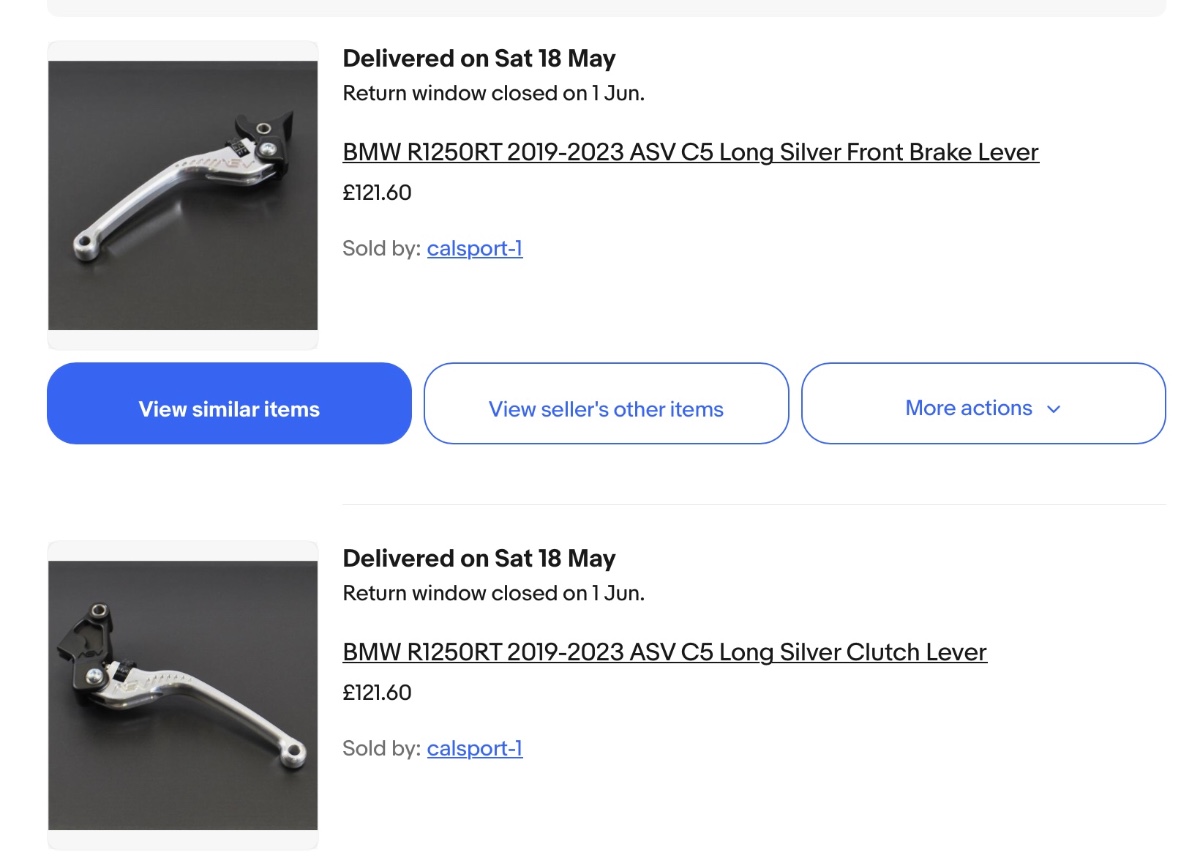

I went with the ASV levers from eBay. £243 the pair.

I ended up getting some ASV levers. (Right from ASV - which was great because you can pick whatever color you want for the levers and adjustment knobs) They certainly allow plenty of adjustment.
Seems like the cheapest of the good quality levers.
Of note when I got the levers they were the same part number, called ASV and they confirmed that is correct on this bike.
