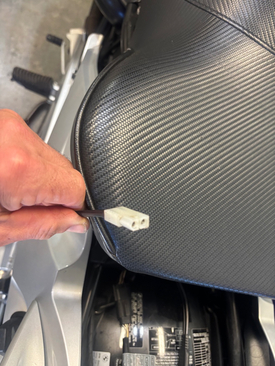

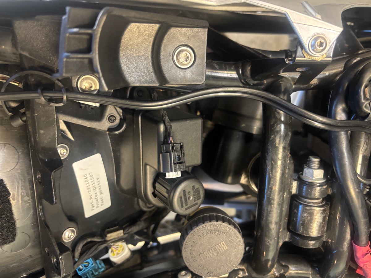

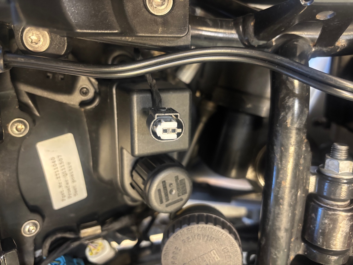

I have a new to me 2007 1200 RT. It came with Sargent heated seat but it was never connected There is an unused connector with brown and violet/black wire. There is no power there unless the engine is running. No constant power. If I connect the meter the current jumps to 10-11V then drops down to 0V. Could this be because there is no load on this circuit? Is this the ftont seat heat connector?

Unused connector
Unused connector
Unused connector
Unused connector
Seat heat connector
Seat heat connector

Have you tried just plugging in the seat? The worst it will do is trip the cam bus. If it does, unplug and turn the bike off, then on again. Cambus will reset itself again.
