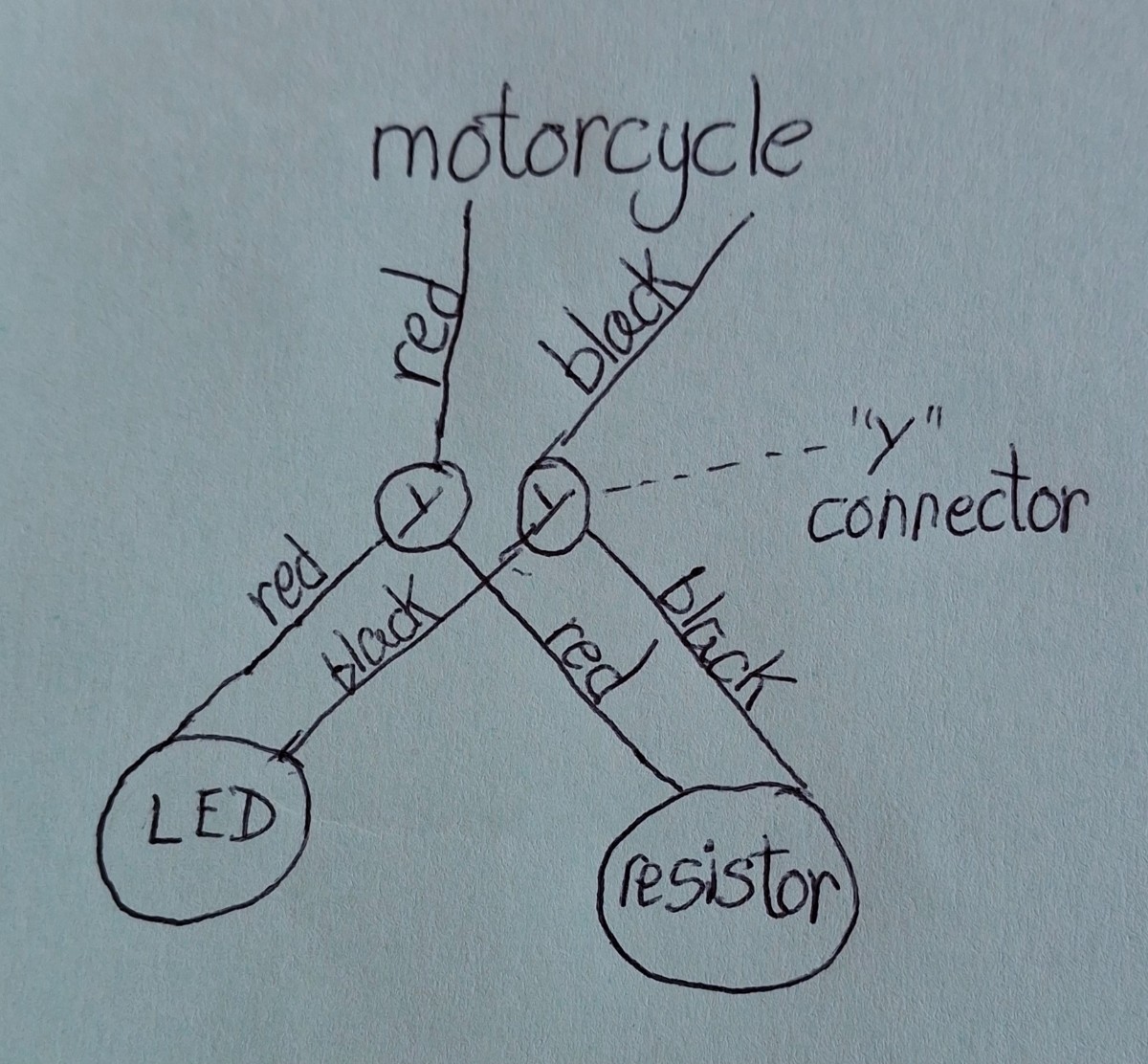

I'm guessing you have to create a Y for the red and another Y for the black to create a red/black pair for BOTH the light and the resistor.
I'm going to draw it out in a way that makes sense to me, photograph illustrations, and post. This will take time since I'ma sitting in a Starbucks using my cell phone and an Amazon Fire HD10 to do this.

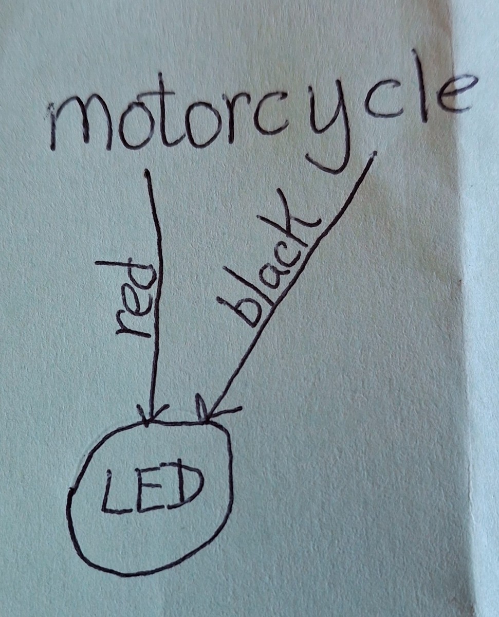

Let's see if I can import the hand drawings:
Before you do anything, you have ....
As far as I understand, this is what you start with. It's simple circuit (circle) from motorcycle to LED light. Isn't it?

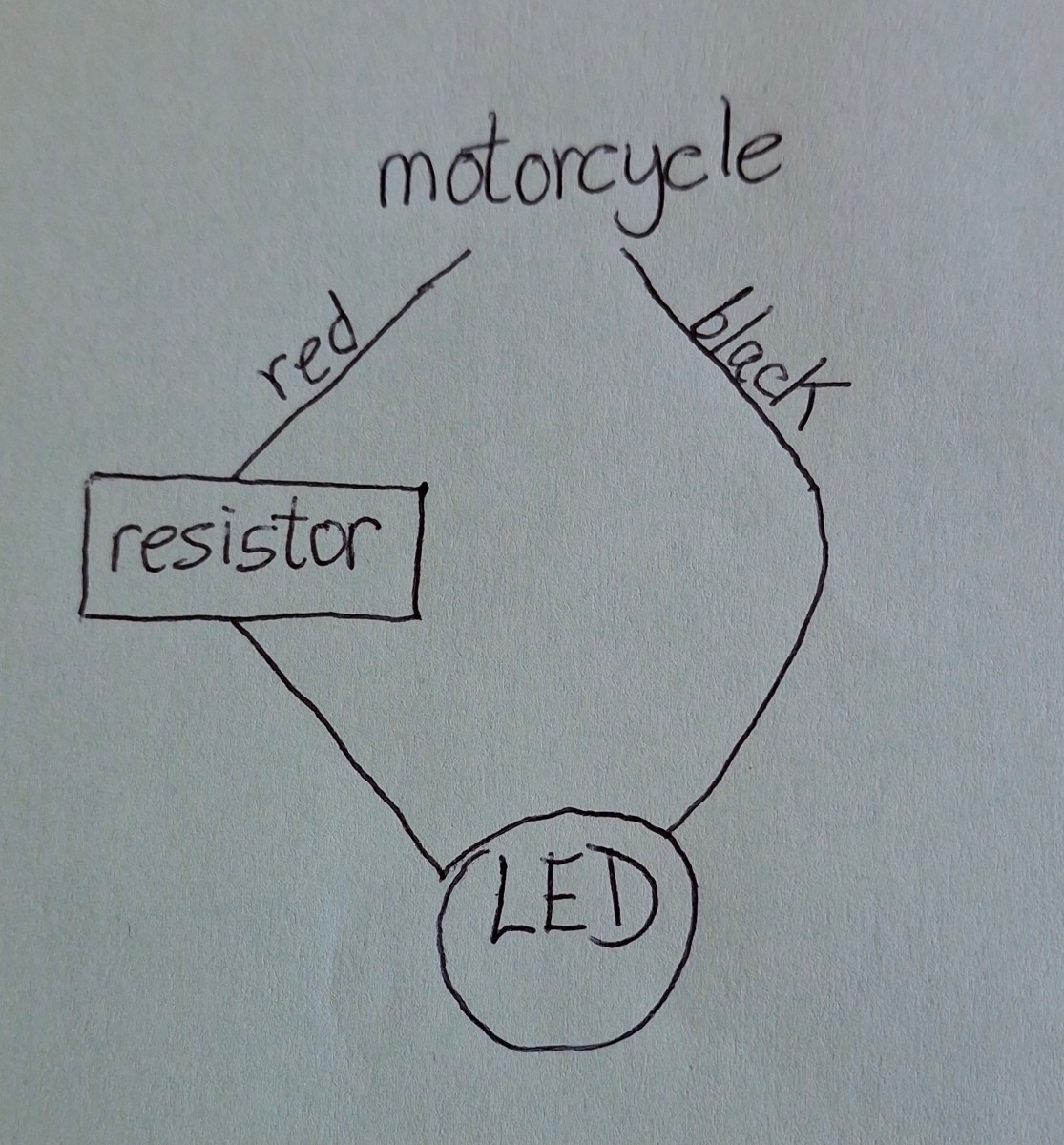

After you put in the resistor, you end up with something like this:
I'm pretty sure that's what I have going now, but that graphic that came with the 10W resistors says it better.
Now, I could try something like this.... If I believed that a "resistor" was something that takes in electricity at one end and puts out 10W LESS out the other end.
(This seems intuitively wrong to me since the resistor has no black wire going to it!)
Do resistors work like the 3rd illustration? NO black wire? Just a "pass thru" for red?
Doing something "in parallel" doesn't tell me where to connect wires.
I suspect there is a "BEST" way to wire this... One that makes CanBus happy and generates minimal heat.
'Gosh... I wish knew what that was.

Re: Resistor for BRAKE lights Question
In the second illustration, the resistor is wired in parallel with the LED.
In the third illustration, the resistor is wired in series with the LED.
Parallel is the correct way to do it.

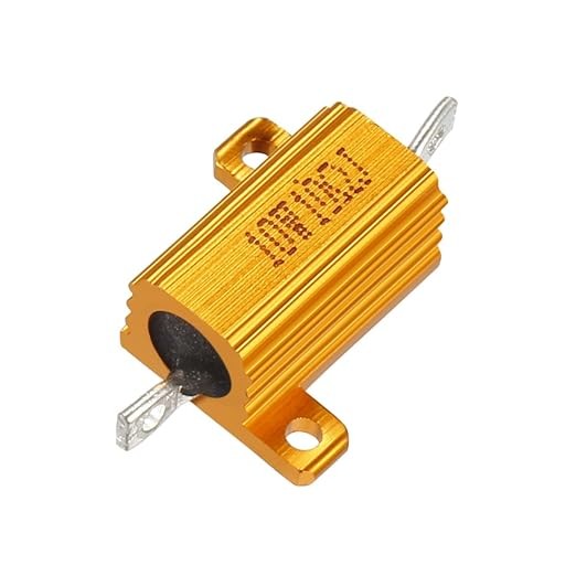

The new resistors arrived.
They look like this
I'm guessing I should wire one black and one red to it...just like the ceramic.
Does it matter which wire goes to which end?
- Strat Tuner(Yamaha FJR 2012)
- Willie Nelson
Strat Tuner wrote: Tue Feb 25, 2025 4:53 amDoes it matter which wire goes to which end.
No.

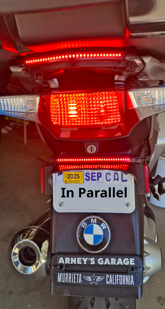

I'll start where I finished.. with the photo.
- put new aluminium resistors in
- Everything worked (resistors got really hot just in the garage!)
- Added another LED strip along the trailing edge of the top box platform (will canbus tolerate that?)
- CanBus didn't mind
- stood back and thought about things for a long time
Adding the second led strip ABOVE the factory brake light made a big difference! With that in, did I really need LED bulbs in the factory tail light housing? Maybe, but NOT at the expense of peace.
There's NO peace riding along on a potential fire hazzard.
I decided to strip out BOTH RESISTORS and put in one 1156 standard incandescent mated with the one LED bulb that would work with CanBus. I tested those two early on looking for something that would work with CanBus and NO resistors. In the photo, that accounts for one side being brighter than the other inside the factory tail light. Now, I can roadside repair it by carrying two duplicate bulbs under the seat!
I could have put in two 1156, white, filament, incandescent bulbs... which is what was there to to start with.
The two LED strips, one at the top of the plate and the other on the top box platform, do a bang up job! ... AND.... there are NO resistors!
It would be visually better if one of the LED strips were completely OFF and came on only when I apply the brakes, but that's not possible.
