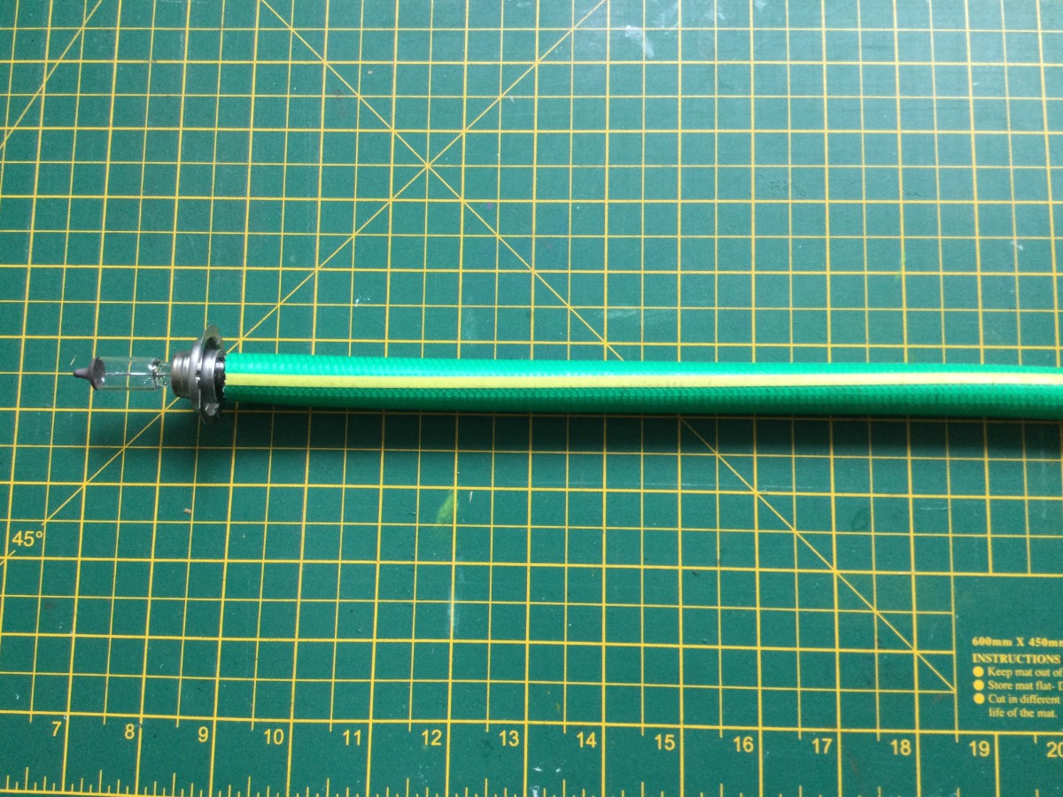

H7 LED
What a great idea, just tried some 1/2" ID garden hose over the two spade connectors on a H7 bulb, works a treat.

Recently had to replace two headlight bulbs, used the garden hose trick.

David. wrote: Sat May 11, 2024 4:17 amRecently had to replace two headlight bulbs, used the garden hose trick.

David. wrote: Fri Jun 07, 2024 6:05 pmHose.jpeg
How did it go 🤔, when I change mine I’ll go for the Phillips extended driving/ long life bulbs.
Hahahaha !! There I was patting myself on the back for having thought of this trick myself, and then I see 10 people who thought of it years ago!
