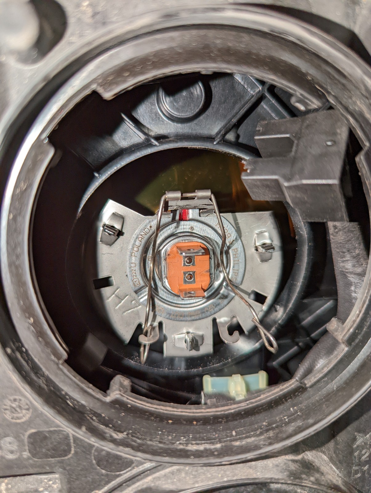

This is how far I got without removing Tupperware. After I got everything disassembled, it took a pair of pliers to get the left clip off. It was not a fun experience.
Maybe this photo will help others that are feeling around in the dark in a parking lot.
Hopefully you will have better luck
