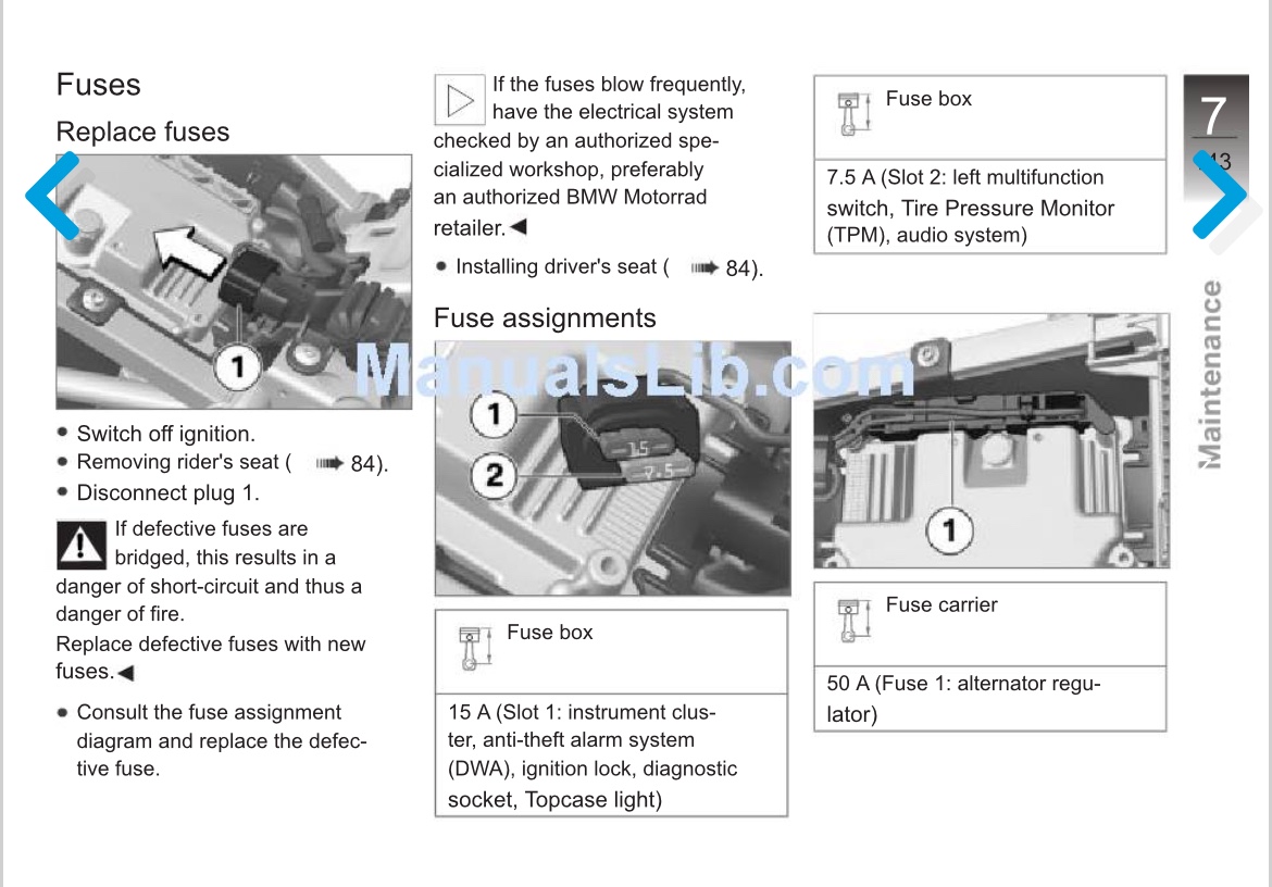

Hi, can someone tell me where the main fuse is? I've looked online at the fuse box and can't see a "main fuse" listed. Thanks Pete
Re: Disconnecting battery
no fuses. The bike uses canbus system
7vwh
Posts: 268
Location: East Yorkshire, UK
Has liked: 18 times
Been liked: 40 times
Post by 7vwh »
Fuses under the rider’s seat.
