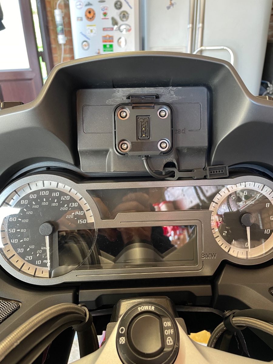

You can also buy bolts and fit the XT cradle in front of the existing cradle, which is what I did. There is also an aux lead that will allow you to connect the cradle to the same power socket the current Nav cradle draws power from. It is a lot easier to just buy a 3d cradle, but 4 bolts and spacers seemed the more economical route :)
The XT2 will not fit in the same place though
