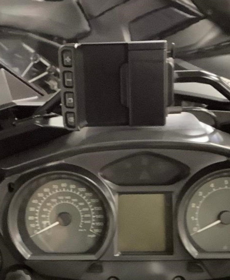

It has this GPS mount but no GPS unit. What would you recommend I do with it?
Find a BMW gps to use with it.
Can it be used with a different gps or iPhone.
Should I remove it?

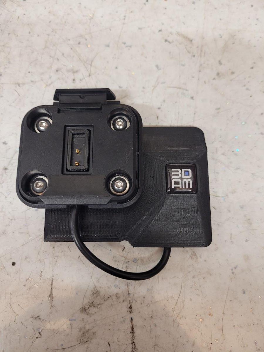

Are you talking about the italian 3DAM adaptor?

Ah you're talking about a mount
I am talking about an adaptor that allows you to mount most sat navs to the nav prep and take its power from there
Like so

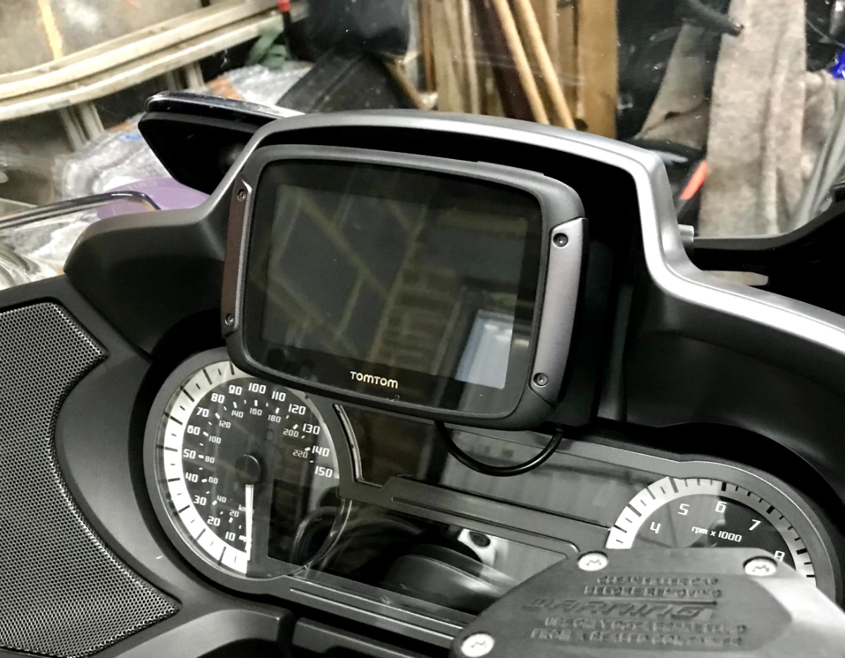

sakm wrote: Thu Mar 28, 2024 2:08 pm Ah you're talking about a mount
Like so
Italian. Here’s mine fitted in the OEM BMW Navigator mount with the adaptor and Tomtom

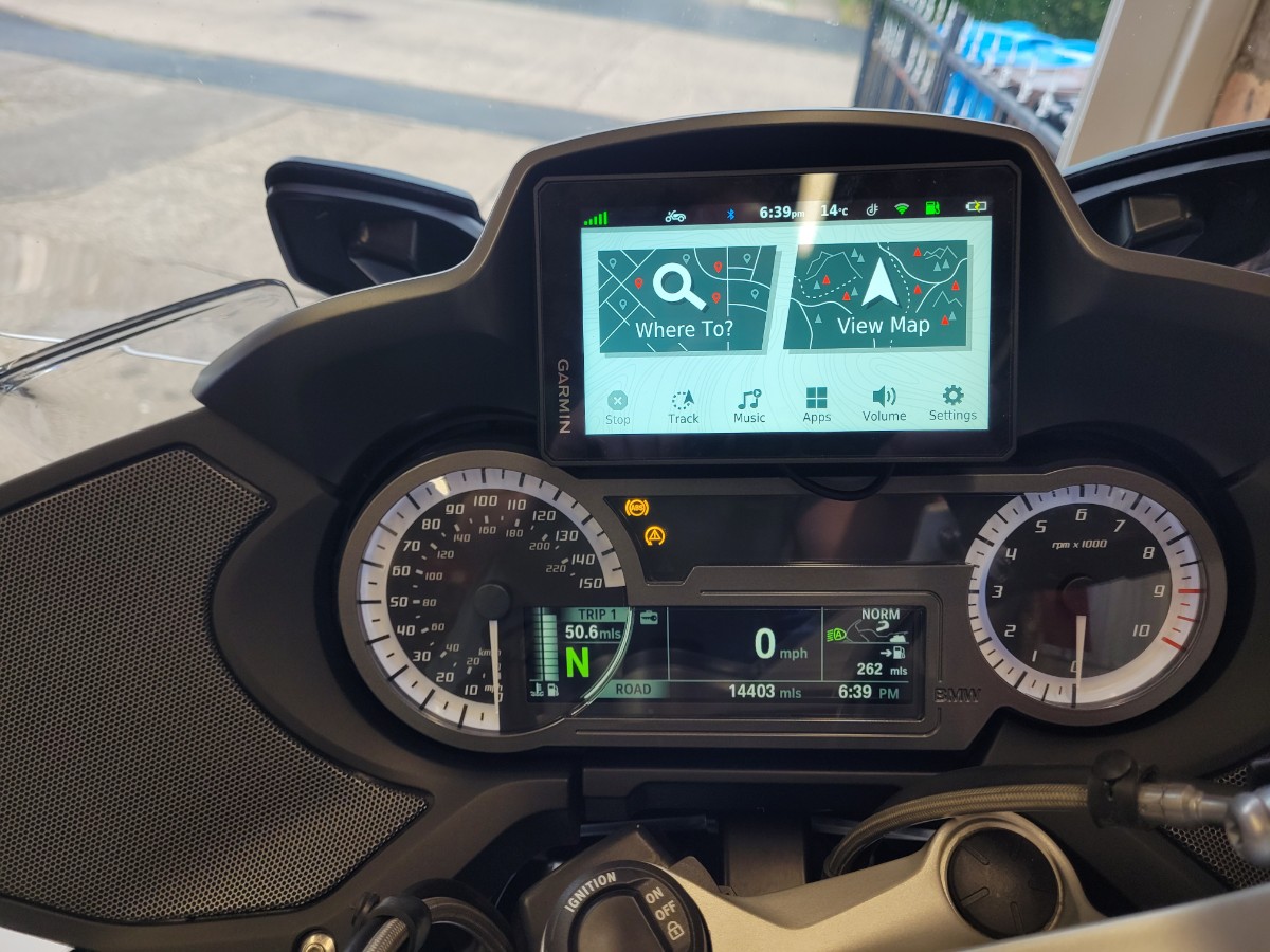

sakm wrote: Thu Mar 28, 2024 2:08 pm I am talking about an adaptor that allows you to mount most sat navs to the nav prep and take its power from there
That's exactly what I use with my R1250RT and Garmin XT. It looks as OEM as you're going to get.
