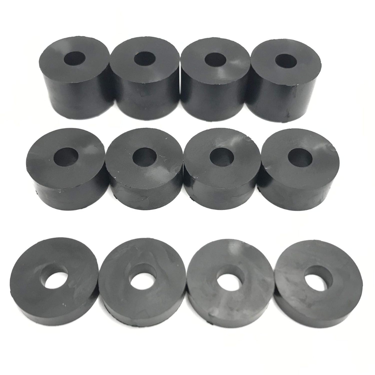

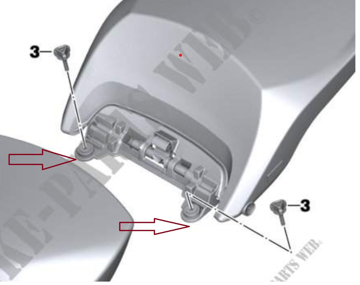

I fitted a set of Amazon Far East knock off footpeg lowering brackets form Amazon UK 18months ago. A complete and exact copy of the better known German make but a third or more of the price. They even seemed to photocopy the fitting instructions.
I'm sure the same can be supplied by Amazon Au.
Ref seat heightening. I tried fitting some of those lowering rubbers, you know the ones with the offset holes, but fitted upside down to raise the seat. They fitted but several bumps later gravity did it's bit and they reverted to their natural 'down' position. They also made the front of the seat look naff with an enormous gap between the front of the seat and the tank/plastics which just looked wrong. What I have done though is to raise the front of the back seat by fitting a 10mmthick and about 20mm dia hard rubber spacer under the lugs that bolt the nose of the front seat down. As the back of the front seat rest on the front of the back seat, the effect is to raise it by 10mm. In theory you've now not got a 'flat' seat anymore, but I couldn't tell the difference and 15,000miles later those spacers are still in position.
