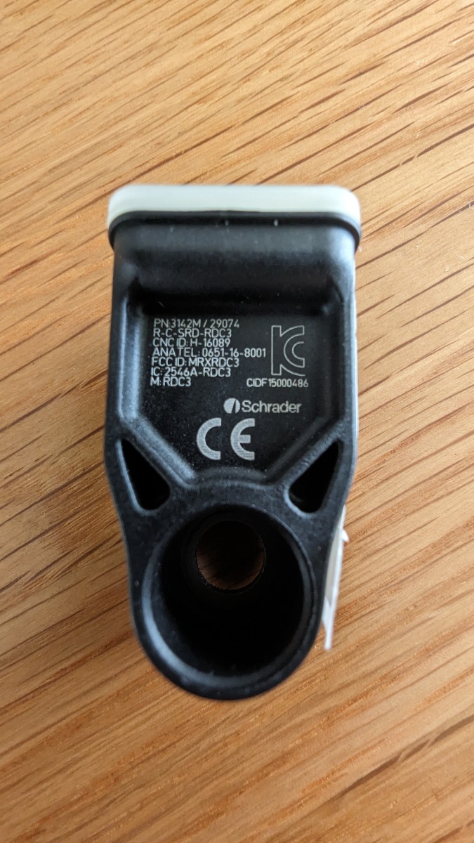

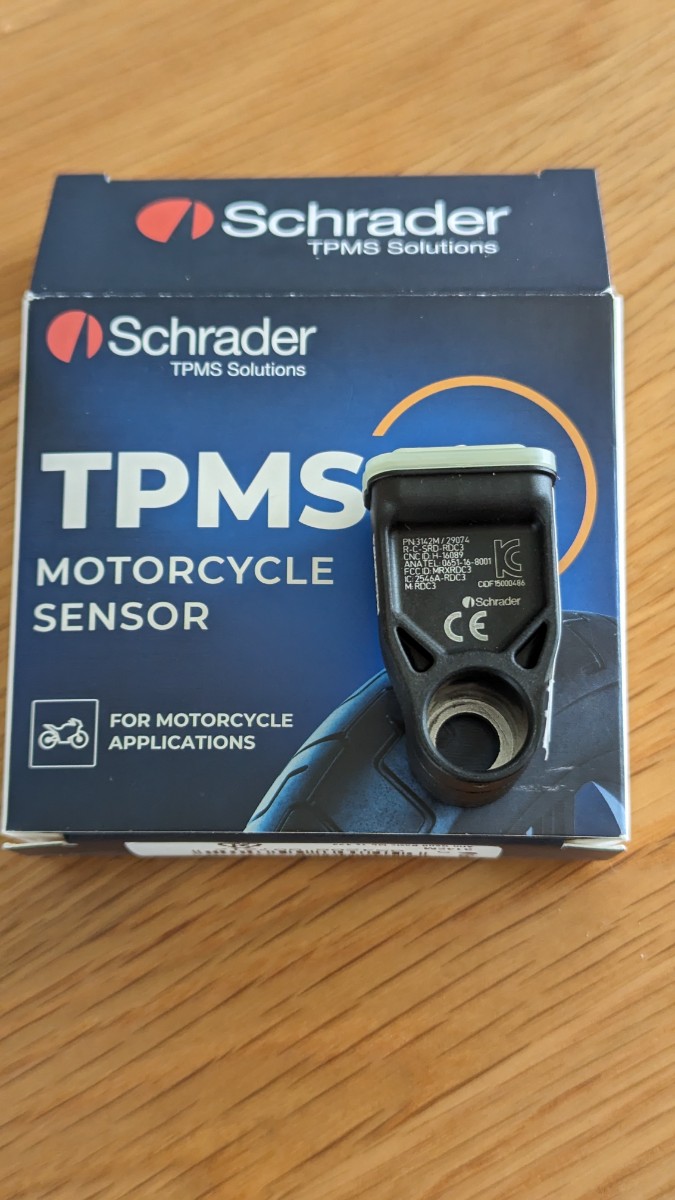

Re: Intermittent TPMS
took the decision to buy two new TPMS
Still waiting for one to be delivered but the faulty one has been replaced and is working fine now
I went for the Schrader 3142M which is the ones for the KTM the BMW one is the 3141M but they are all the same

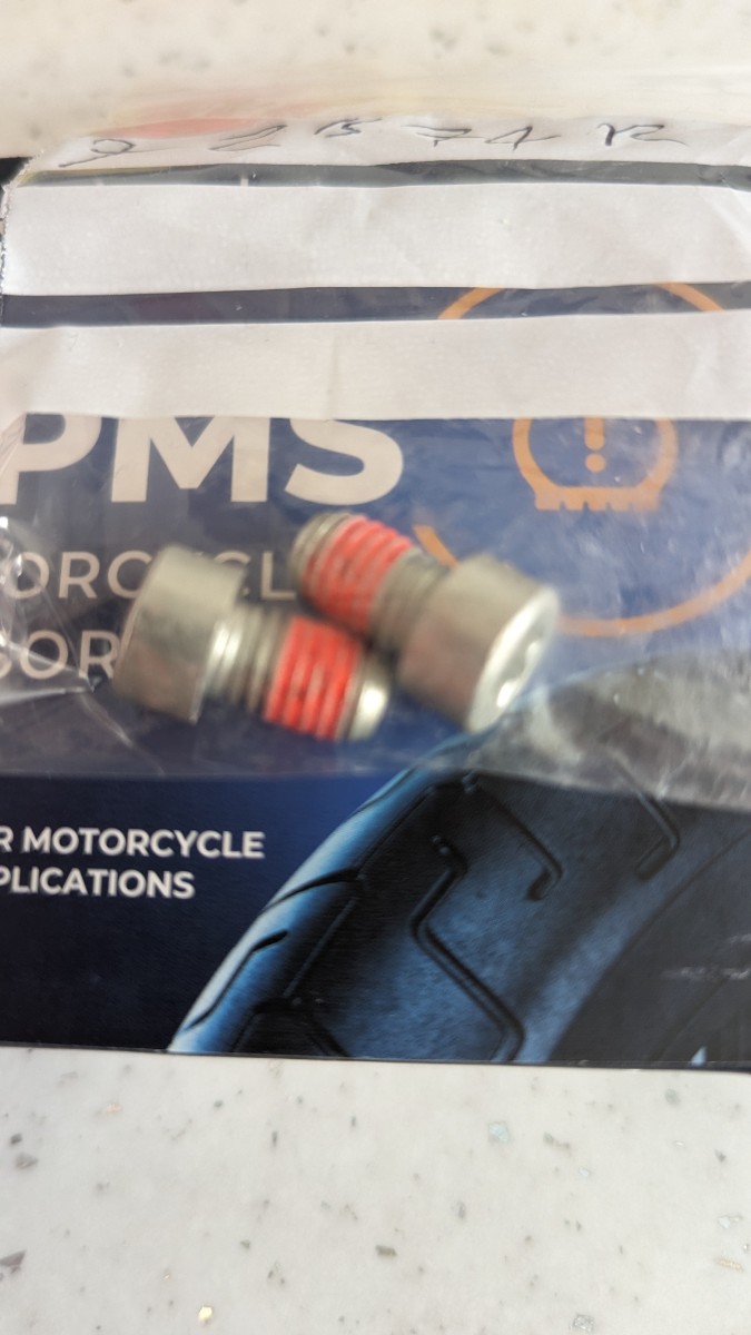

You also have to replace the bolts too
