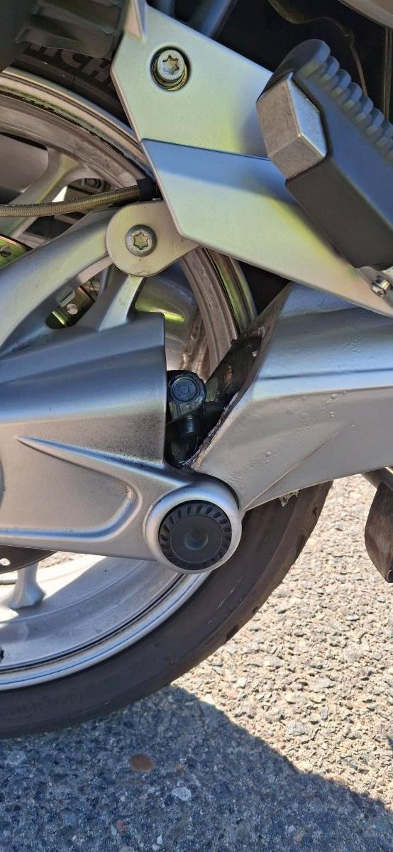

Cruising today on twisty roads...
Slight vibration.. that's new,
3 miles later, worse... Do I have a flat?
A few miles more, heavy vibration, burning smell....
Pull over now!
The rubber cover on the shaft drive burned away. All shaft oil gone. Bare shaft parts exposed. No forward motion in first gear.

It may not be in the BMW R1200RT service schedule but regular inspection and lube of at least the "rear" Universal Joint and Splines is advisable. There are many horror stories out there which no doubt can be attributed to the Out of Sight, Out of Mind syndrome. It's a relatively straight forward job to lower the Final Drive, check the Joint for stiffness or rough movement and clean and lube the Splines. It can be a bit fiddley re-locating the Shaft onto the Hub Splines whilst positioning the Rubber Boot but this gets easier after a few times.
Re: Exploding shaft drives
Strat Tuner wrote: Sat Jan 18, 2025 9:02 pm All shaft oil gone.
There is no shaft oil
The oil is in the bevel gear housing and the shaft is run dry
If there is no damage to anything else then its a simple shaft replacement and rubber boot and you're good to go

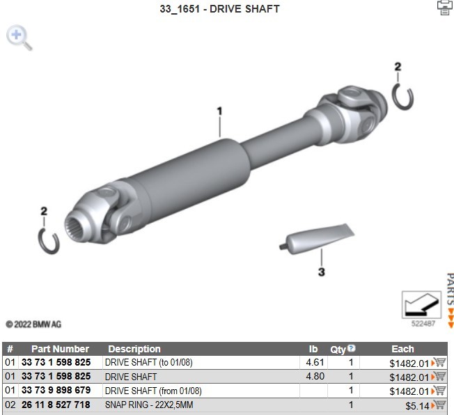

Strat Tuner wrote: Sun Jan 19, 2025 10:08 pmI don't know about splines and exactly which one to order.
Looking at the BeemerShop website, https://www.beemershop.com/category/clu ... -3986.html they list two driveshafts, (20 or 22 splines).
From what I can see, 20 splines up to 12/2007 and 22 splines from 01/2008. Best check with BeemerShop before ordering.
From MAX BMW Parts list for an R1200RT 05-09.
MAX BMW.jpg (46.64 KiB) Viewed 4550 times

David. wrote: Mon Jan 20, 2025 11:50 am Looking at the BeemerShop website, https://www.beemershop.com/category/clu ... -3986.html they list two driveshafts, (20 or 22 splines).
I sent the following:
Dear BeemerShop, My shaft drive failed this week. I'd like to order a replacement. I don't know if i need 20 splines or 22. The R1200RT is 2008 (I think), and the VIN is ---------------------------.
